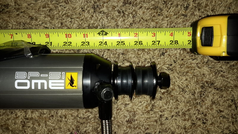

    Rear BP-51 OME shock, length when extended as measured from the center of lower mount eye

    Thanks... now does anyone remember what stock length is? lol

    looks like ~25.5
    shackle flip with dakars preferable length is needing ~27ish
    looks like the jk 4" front extended shocks BPS5160022(front shock has same mounting style as rear Tacoma) are 16.5 collapsed and 26.8 extended....which makes it interesting as the B110 RCD Bilstein's are 16.34 collapsed and 26.34 extended.
    might work with minimal modding? who has a friend with a JK to measure?

    • Rear, 22.94 is the extended length of 0-1" option Billies on Down South Motorsports website. I'm guessing oem would be about the same.

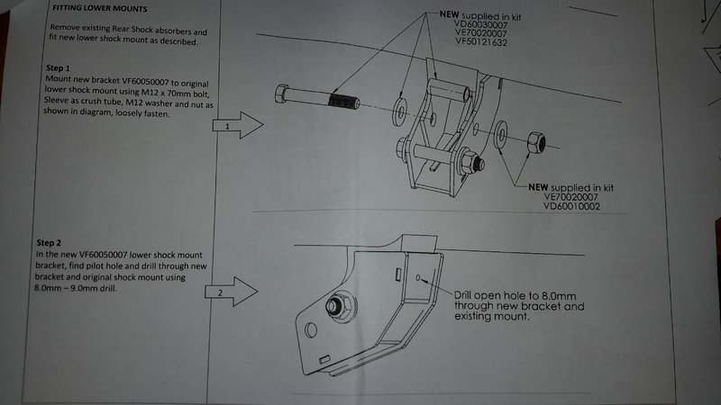

    @luka that does seem to be a viable option , the jk shocks look like they could be swapped with the tacoma ones , looks like you would just need the fit kit that moves the mounting position farther from the axle, my only concern would be the valving , weight cap, etc. Too late for me the taco BP kit is going in on tuesday, would be interesting if someone tried this option
    BP5160021 SHOCK: JEEP 4+ FRONT 633 633mm/395mm (24.9in/15.6in) 2* $510.00 July 2015
    BP5160022 SHOCK: JEEP 4+ FRONT 683 683mm/420mm (26.9/16.5in) 2* $510.00 July 2015
    BP5160023 SHOCK: JEEP4+ REAR 685 685mm/422mm (26.9/16.6 in) 2 $510.00 July 2015

    I don't think weight will be a big issue, but valving would be the unknown variable. playing with the settings might help mitigate it though. i'll continue to dig for whatever I can. might be a little stuck until more information is put out.
