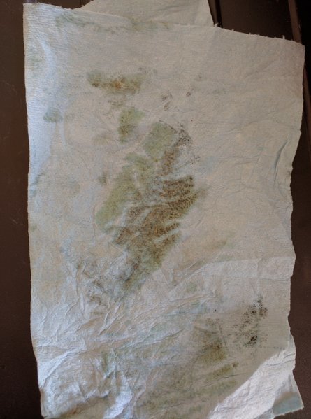

    Soo I've got oil coming out of the rear remote hoses... Last week I went to the car wash and hosed them off and dryed them with a rag. I just felt them today and they were wet so I grabbed another rag..

    That's not good. I better take a close look at mine too!

    And only after one offroad trip. Note, no drips, just wet.

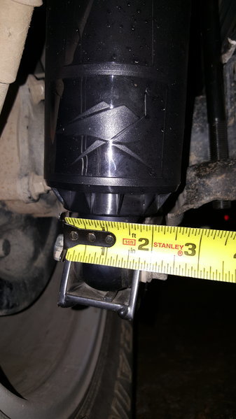

    so I measured a JK today, top shock mount looks identical, lower shock mount on JK is ~1.5" and the Tacoma is ~1.25.
    looks like the fit kit gives the Tacoma a 1.5" width mount.
    anyone with the Tacoma able to measure to confirm?
    I think the JK front shocks will fit in the rear without any issue.

    Wow that sucks , sorry to hear that is happening to your shock. I checked in on TW and read your post at my first stop post - install. Checked and no leaks here. I hope they replace yours and that it doesnt turn into an issue for us early-adopters of this new suspension kit. Will be interested to hear the diagnosis as to where and why the leak is occuring,

    Would you be able to measure the width of the lower mount on the kit? I'm beginning to think the kit is more for the width of the shock mount and not so much pushing it away from the axle.

    Here you go, it was hard to get in there because of the rooster guards but I did my best. Guessing the steel is 3/16ths, or some MM , stuff does come from Australia

    Hmm glad I got under there for you, it looks like the guy used wrong bolt on lower shock mount. Not happy with number of threads seated , going to have that fixed
