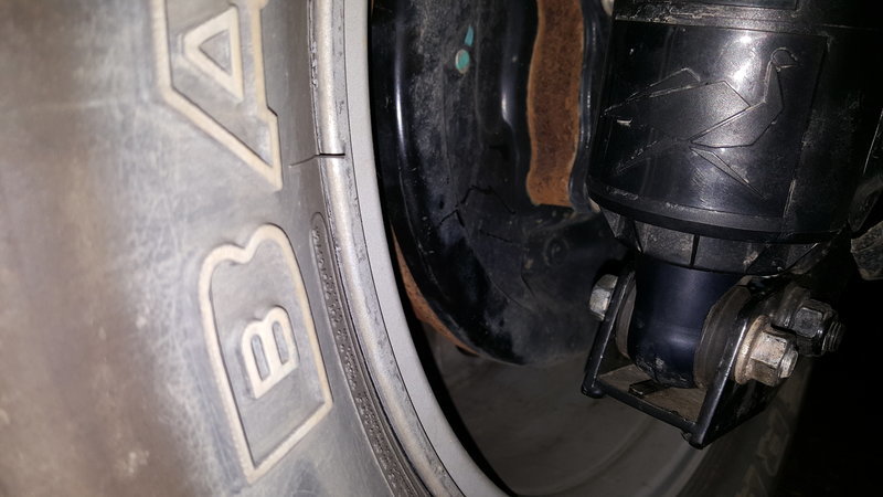

    Yes with that much oil that's a leak for sure, bummer. Hopefully they can have a look at the shock to diagnose the issue..

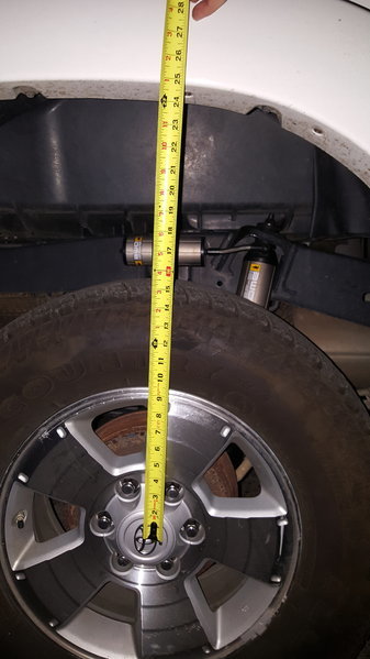

    Thanks, I didn't bother adding my hub to fender to oz-t's dakar height thread because I'm an inch and a half above his averages. @Blackouts got 4 inches on all four corners https://www.tacomaworld.com/threads...ff-road-4x4-build.424764/page-3#post-12576383 he measured with a laser level. I'm at 25 3/4 on drivers and a solid 26 on passenger side. anyone else have hub to fender measurements?

    886s:
    Driver front
    22.5
    Driver rear
    24
    Pass front
    22.5
    Pass rear
    24
    BP51s:
    Driver front
    23.25
    Driver rear
    24.5
    Pass front
    23.25
    Pass rear
    24.5

    Guess I'm within a fraction of an inch of others with Dakars oz-t thread has an average of 24 5/8ths for DCLBs post dakar install, I was at 26 before the shell
