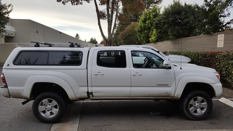

  4. Nov 7, 2016 at 4:04 PM
    #464
    IronPeak
    IronPeak PermaLurker
    Mar 9, 2016
    #180799
    3,232
    AuggieX
    Back to Back
    2007 sr5 4x4 DCLB/2015 TRD sport 4x4 DCLB sold
    Bigger Taller Slower
    I asked the installers to adjust them a cm on the passenger side and .5cm on the drivers but they failed to read the instructions and perform this off the truck. so I left them at the from factory height. It does need to be done off the truck. I adjusted the compression down 2 notches in the front as it was a little stiff. I'm at 1+" rake, loaded im closer to level. all in all happy especially with the ride.
