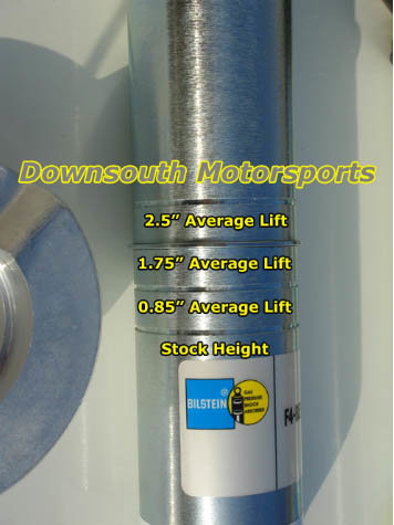

    this look like notch zero.
    if you can get the shop to raise it to notch 1 or 2 you might get a little more lift in the front and stop the rubbing.

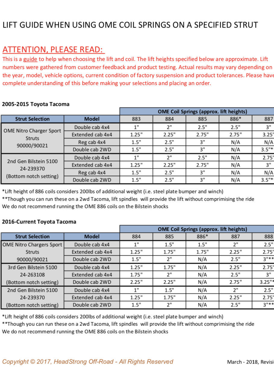

    No one seems to mention what version of the Bilstein 5100's they have. It makes a difference. Here's a good guide from Headstrong.
