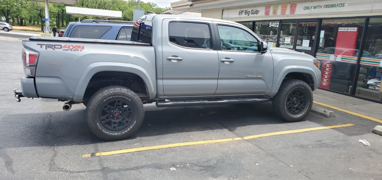

    I have lot of rake with 887 and 5100. would 888 help Or put stock coils and set 5100 at top notch? These are 5100 from a second gen

    Why not just go up one notch with the 888s? They've sagged (compressed) enough where I dont think it would make a huge difference unlike trying to compress brand new 888 springs on the 2nd notch.
    Stock springs all the way up might make a real stiff ride.

    I’ve soon many people against this but might have to try it. The ones on during that pic were 887s. I switched to 888 went to 4wp and brought them home and installed. Still though minimal difference

    Sorry to hear that but based on my experience you’re going to see at least 1/2” sag after 3-6mo. We need a higher spring rate, so 886’s would’ve been a good option.

    2008 Toyota Tacoma 4.0 2020 Tacoma TRD Sport
    Damn. Gonna have to order them because it’s killing me to see that rake.
