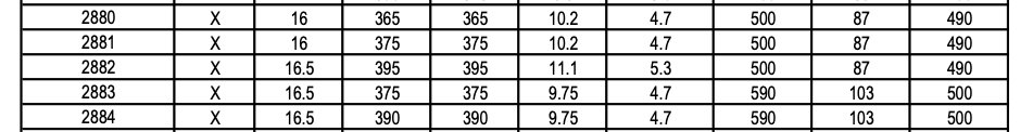

    a friend of mine who has a low milleage OME 884 spring (for hilux/2nd gen taco) he offered it to me and its some kind a gift for me.. i do a lot of research and i can't find anything about, but i found that 882 and 883 (not made it for this model) can be used on our first gen tacos..
    so the thing is, the 884's fits 1st gen taco?..
    here are some facts/tech data for analysis:
    884 (390mm) is 5mm lower than 882 (395mm), but OME 884 have a higher compression rate (590) than OME 882(500) and the same compression rate of the 883(590).
    884 have the same number of turns and same Bar diameter of the 883.
    My truck is a 98 4cyl, with a bumper (not oem/stock) and 9000lb warn winch, my idea is to install and ARB bumper with the winch.
    i also attached the picture of the OME catalog springs info.

    It will physically fit, but you'll get way too much lift and a shitty ride.
    Stick with 882s or 883s.

    I think the 882 is what you seek. For 4 bangers, add a half inch to whatever OME says on their site.
    For instance, an 880 is a 1.5" lift coil on a stock V6 taco. On my 2.7L taco I got just under 2". With a bumper and winch Id likely see that 1.5" they listed.
