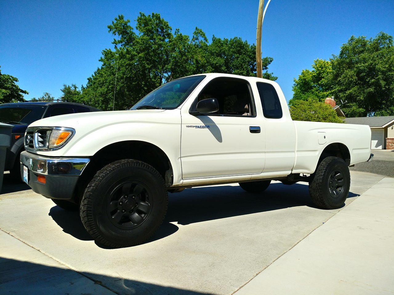

    My 95 V6 with 115k sits 2 inches lower in front than in the rear. I've been looking at Bilstein 5100s, but I'm afraid the 1.25 wont be enough lift, and 2.5 will be too harsh.
    Now I'm looking at OME 881s, but don't know if I need to replace shocks with them. Additionally, should I replace the bushings as well? I would like to get about 3 inches of lift in front, and add a block in the rear.

    What size tires are you planning on running? Just curious if that's why you have 3" as the number in your head for how much lift you want.
    If you're going to replace some suspension components it's probably easiest to just get new shocks and coils at the same time - try to avoid blocks in the rear and go with a 3 leaf add-a-leaf or a new leaf pack if you can.

    Sorry, it has 31x10.50's, not really planning on going bigger.

    The 881's won't get you a full 3" in the front - you'd need either the 882's or maybe Eibach springs if you want to lift it that high. But honestly I'd recommend maybe not going quite so high if you aren't planning to get bigger tires - the 31's will look pretty small on that much lift. As stated above, avoid blocks in the rear if you can. Now would be a good time to replace your shocks as well - OME Nitrochargers or Bilstein 5100's are good options.

    I can't tell if you're 4x4 or not, but if you are then your cv joint boots will rub and wear through if you go higher than a modest 2.5" lift. If you need more clearance for bigger tires you could do an additional 1" body lift, but since you're planning on staying with 31's (let's say 33's :stirthepot:) you should be fine without one.

    I think I'm leaning towards the 5100's and see where it ends up with 1.25. Is 2 inches lower in front normal, or are the shocks worn out?
