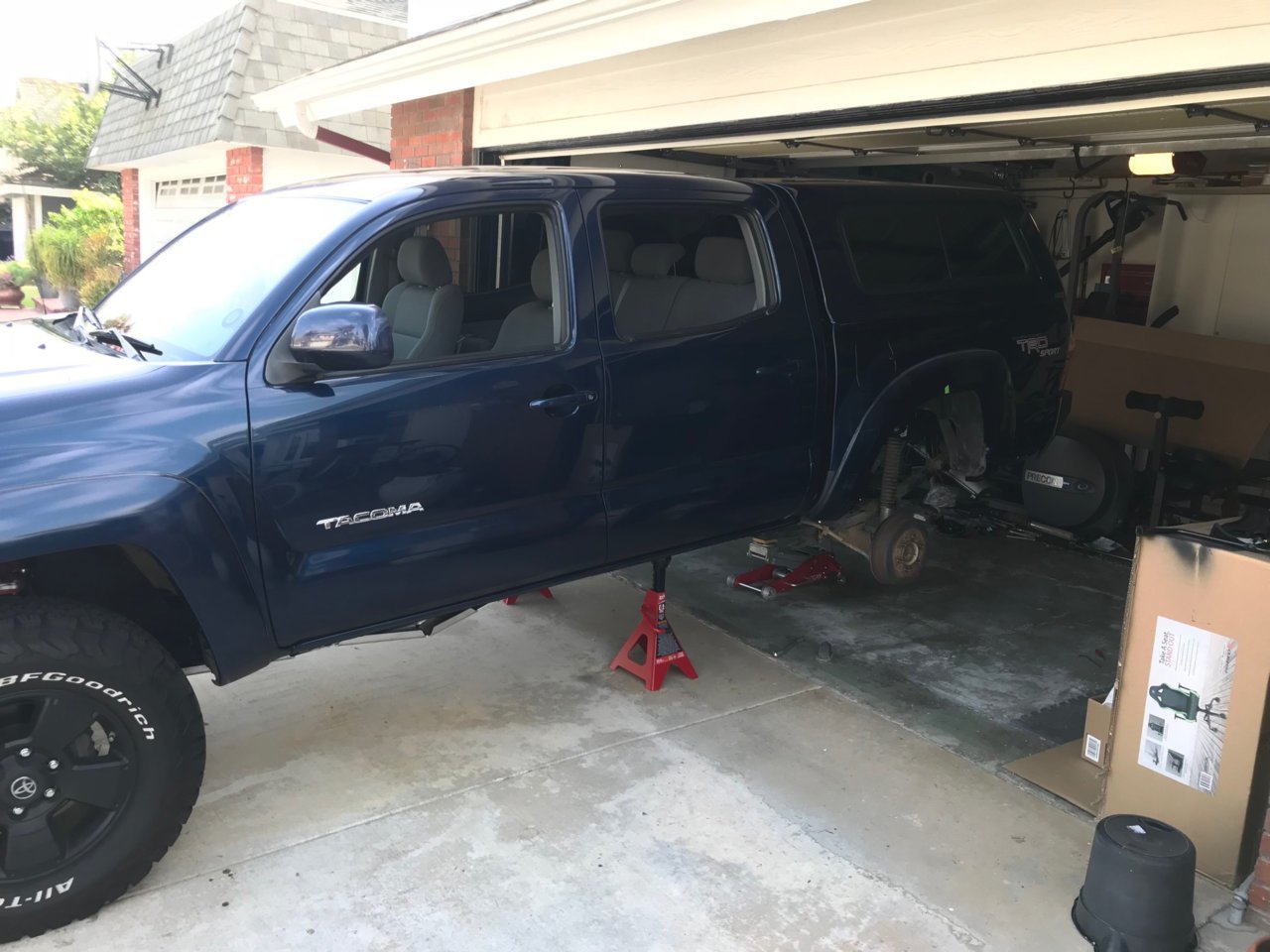

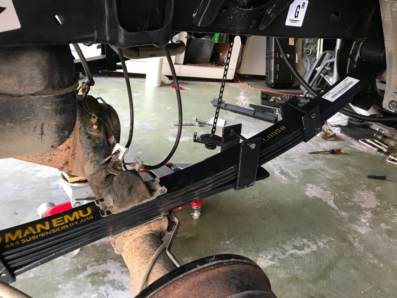

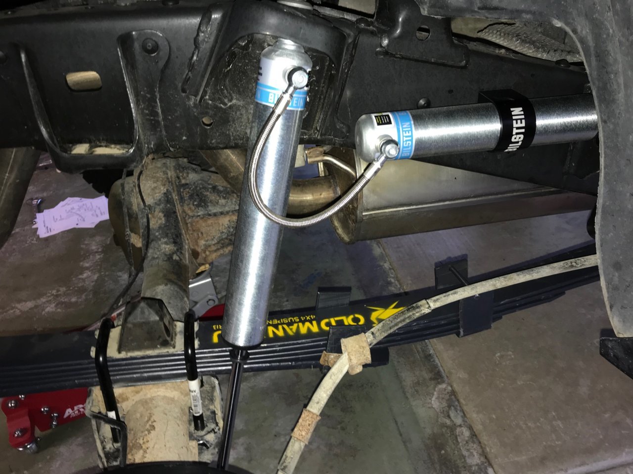

    So I went back & forth - AAL vs. new leaf pack. In the end the Head Strong 3-leaf AAL was out of stock so I got the standard Dakars from HS instead. I wanted less lift so I removed the top overload leaf. That kept the normal operating spring rate and gave the desired 2" lift. Have only a couple of checking it out miles on them as install was over the holiday. FYI, made my own new centerpins (with enough thread) by grinding down the head of grade 8 flange bolts. Here are various pix from the install.IMG_5090.jpgIMG_5110.jpgIMG_5112.jpgIMG_5116.jpg

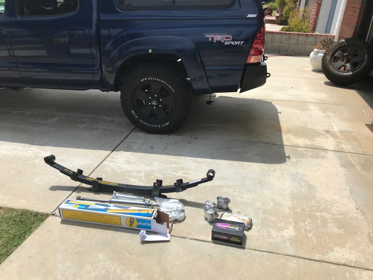

    Hi I like that you removed the longer overload leaf. I want to do the same, I hear people say you can remove the 3rd leaf if you want a lower lift....is this true? I only need about 1.5-2in max lift for my rear. Curious if it would be ok for me to remove an overload and one regular leaf spring. And then add them back in later after settling if needed.

    Ok got it, so in this photo was the final set up ? which would be the correct leaf to remove? 3rd leaf down from the top?

    Hi assume you're referring to the photo in your earlier quote. That's the medium duty pack...not positive which to remove or how much lift that leaf pack will give you. I have the older style Dakar which is the equivalent of the current heavy duty Dakar.
