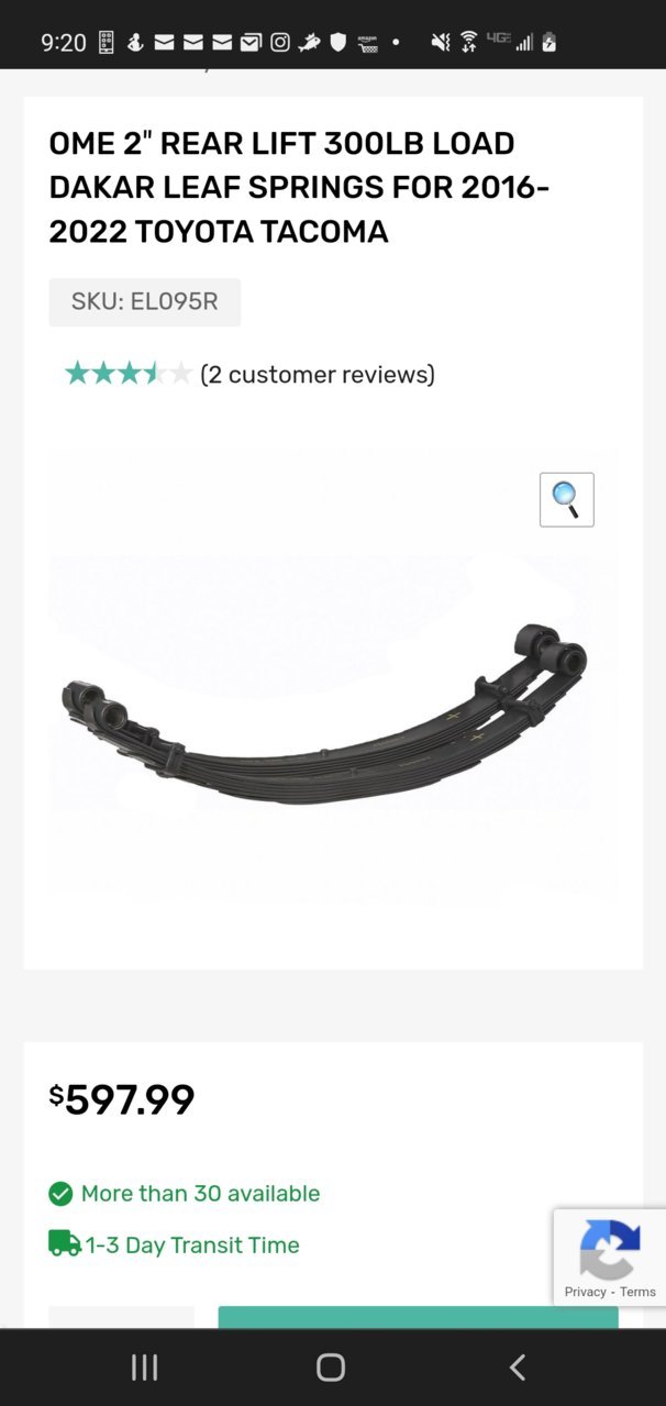

    BFG KO2 265 75 16 Front coil spacer.....
    After installing these I have a shake between 10 to 30mph. I did the carrier drop already. Previously my truck had a 2" block in the rear and when I removed it there was no shim underneath it. What size shim should I order?
    Thanks

    Rule of thumb is 1° per inch of lift

    Any brand shim is fine. Some shims have hole to use center bolt and others have U cut out to slide in place, but those require an extension collar on centering bolt.

    I didn’t extend the pin on my leaf pack. Depends on the thickness of the shim. These are 2 degrees (steel). Forget who I got them from.
    Edit: Warrior Products 800060 2.5”, 2 degree. They got expensive. :eek: They are on Amazon.
