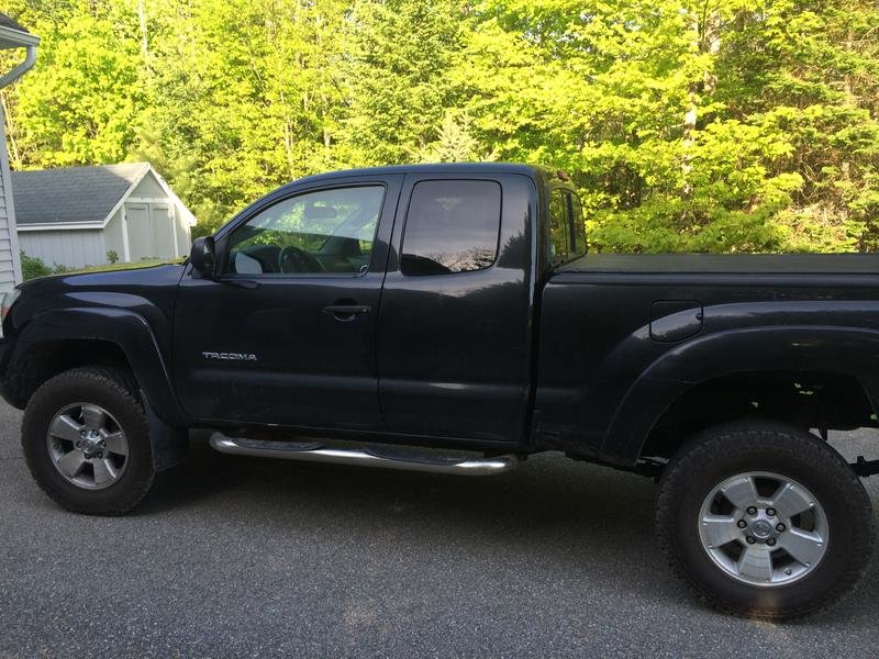

    photo.jpgHey all I just got dakars put on my taco, I have bilstien 5100s front and rear front set to 2.5.
    I need to lift the front a little bit because I have a nose dive now from the new leaf pack what's my best bet for a lift?

    Get some OME nitrochargers and some 887 springs. Should get you just about 3" of lift. Or you could do 885s with 1/4 or 1/2" top plate spacers.
    You could also put a top plate spacer on your 5100s and see how works out. 1/4" should get you another 1/2" of lift.
