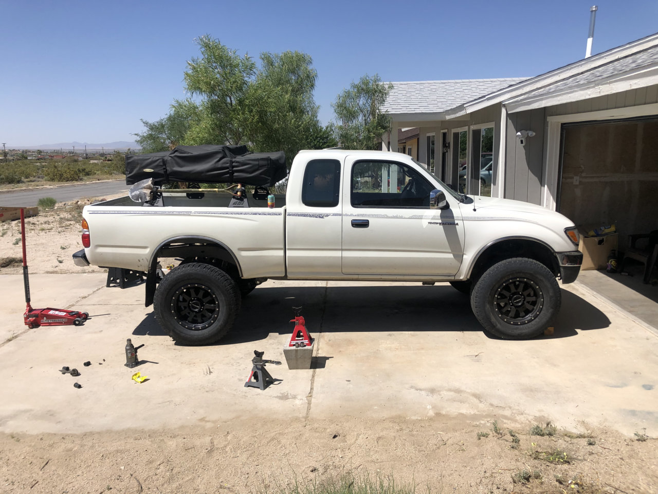

    Yesterday I started installing a set of OME Dakar springs (CS019R) and Bilstein 5100s so I thought I'd share.

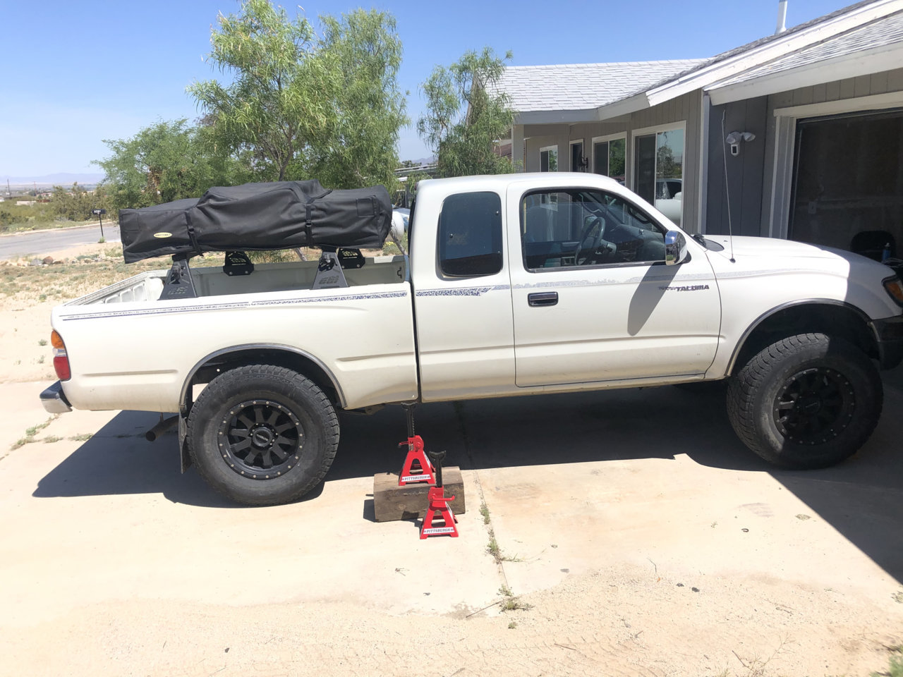

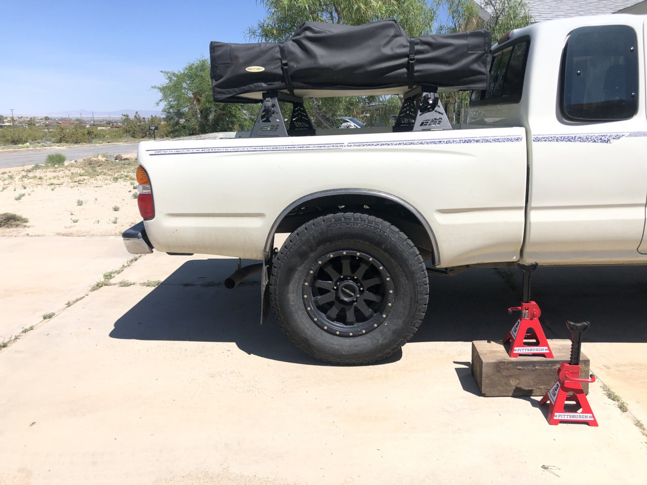

    You can see how bad the bro lean is on this thing. I do have a tent on top, but even without it, the rear end squatted pretty bad. The previous owner took a leaf out of the stock springs because he said it "rides nicer".

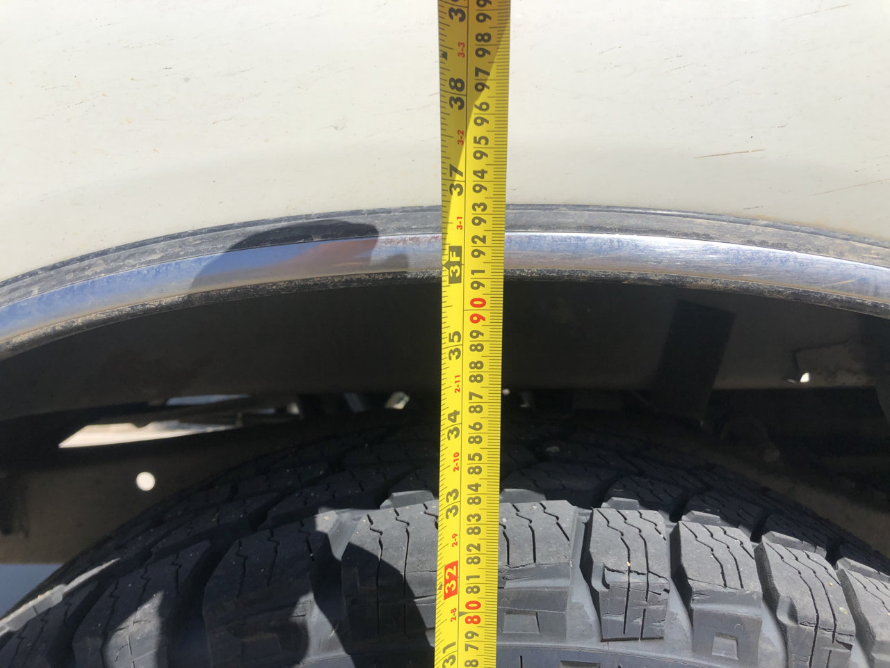

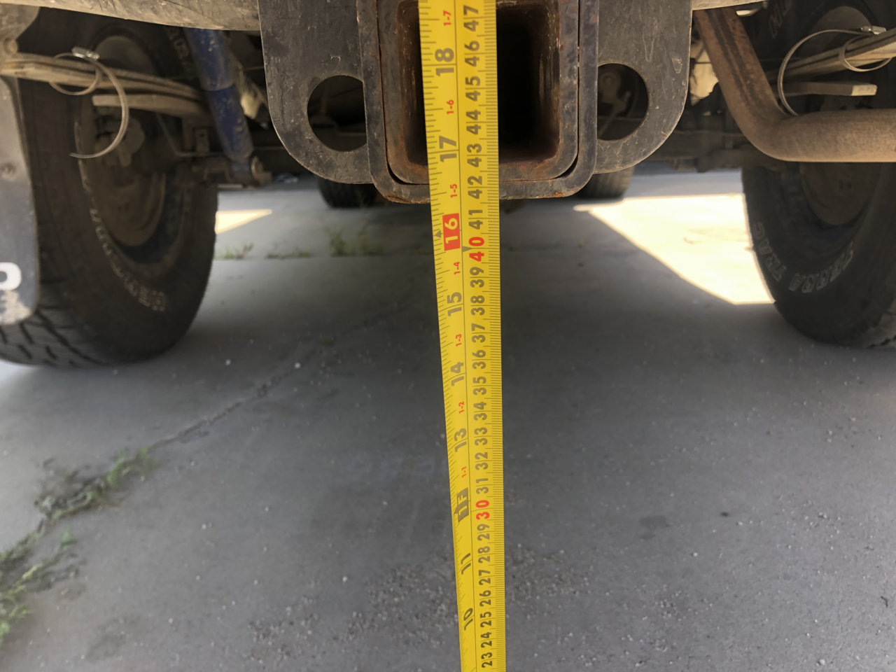

    Currently sitting at about 36" to the rear fender and 16.5" to the trailer hitch.

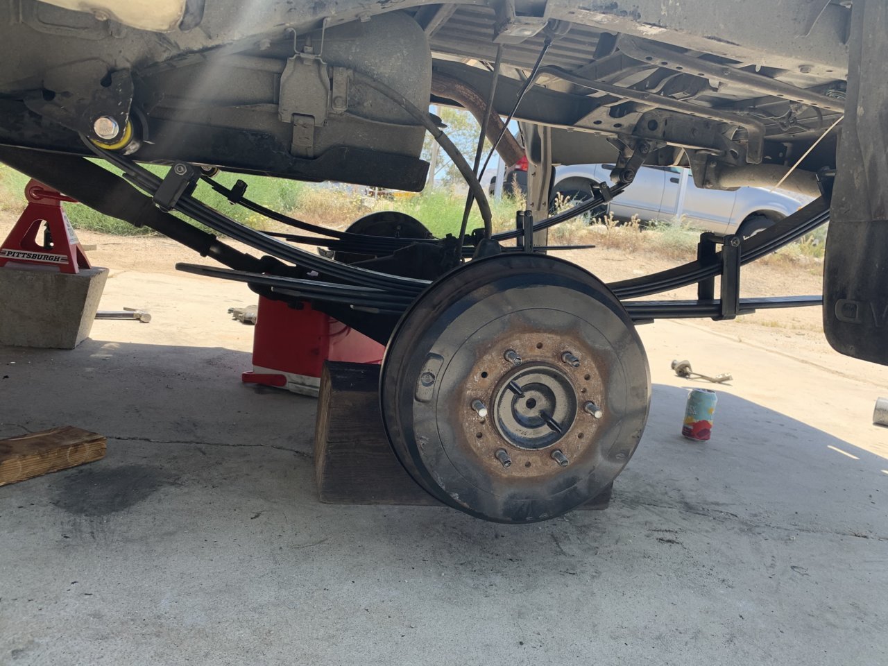

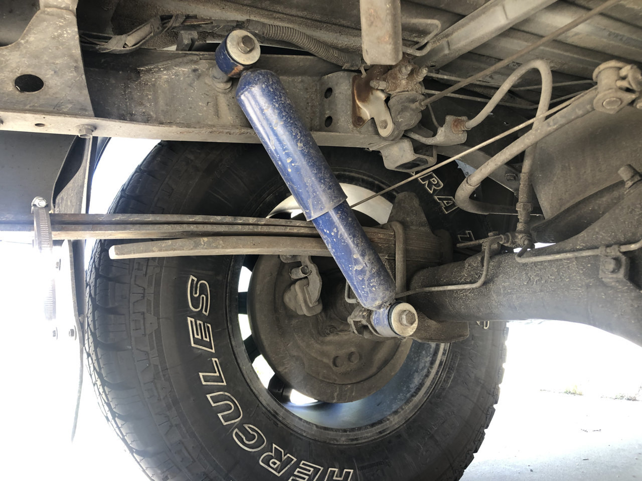

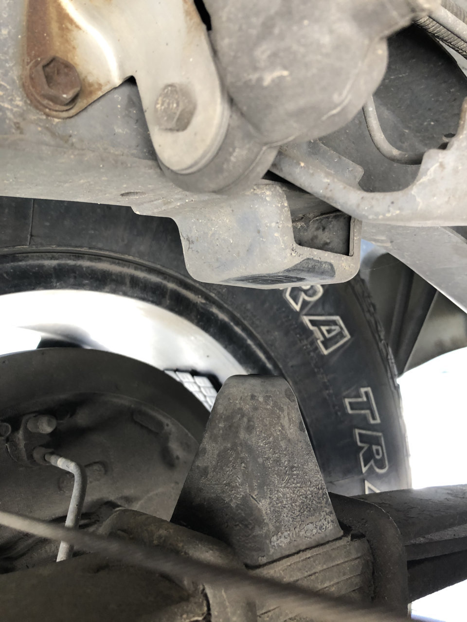

    This is what the old springs look like on the truck. You can see how close my bump stops are to the frame! It's aggravating to slam every time I go over a minor bump in the road.

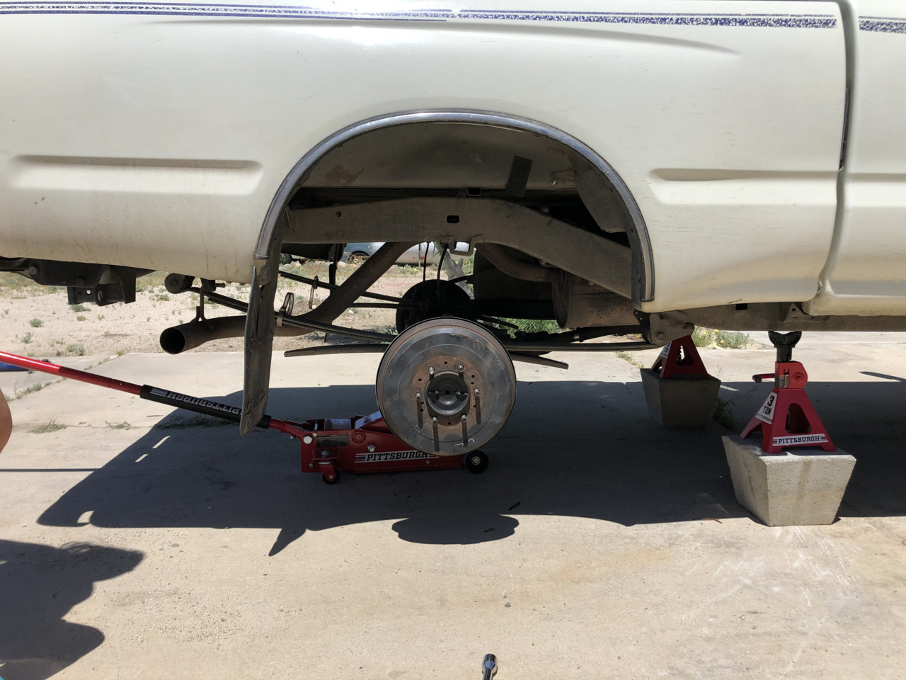

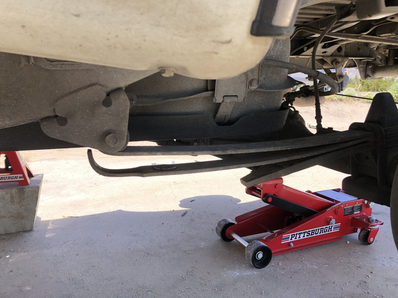

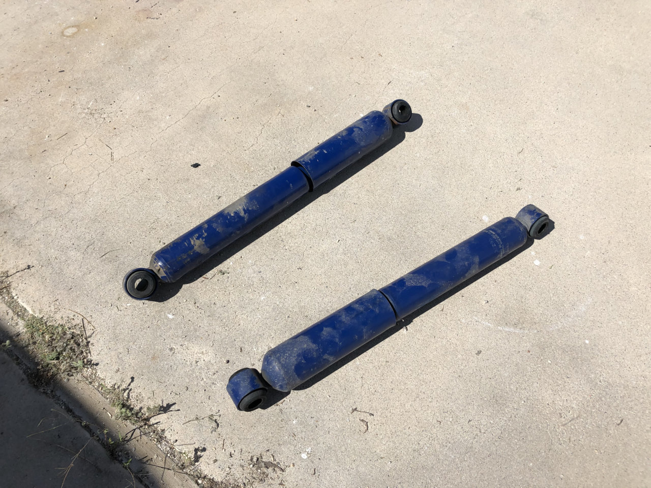

    Took these guys off first, then lifted the rear end by the diff and jacked up the frame.
    This all went relatively smoothly. I started working on the U-bolts and pulling the leafs out next.
    This is the passenger side compared to a brand new OME Dakar leaf.

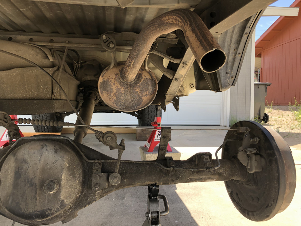

    While I was in here, I cut the exhaust so it would fit the dakar leafs. The driver side gave me a little more trouble...
    The bolt was stuck in the sleeve inside the bushing on the front hanger. This is where it started to go kinda sideways. We tried to cut it out to save the bolt, but ended up ruining it anyway.
    After we got the driver side spring cut out, I found out that my bushings were totally the wrong size. There were all sorts of problems with them, they were too wide, the sleeves wouldn't fit the stock bolts, etc. I bought OME SB108 bushings, which I guess was wrong. Does anyone have a part number for the right set to fit stock shackles?

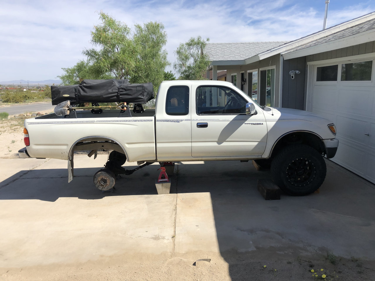

    She'll have to sit like this until I get the new bushings in...

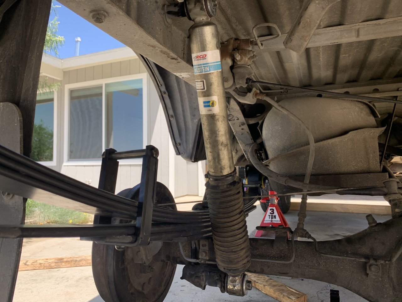

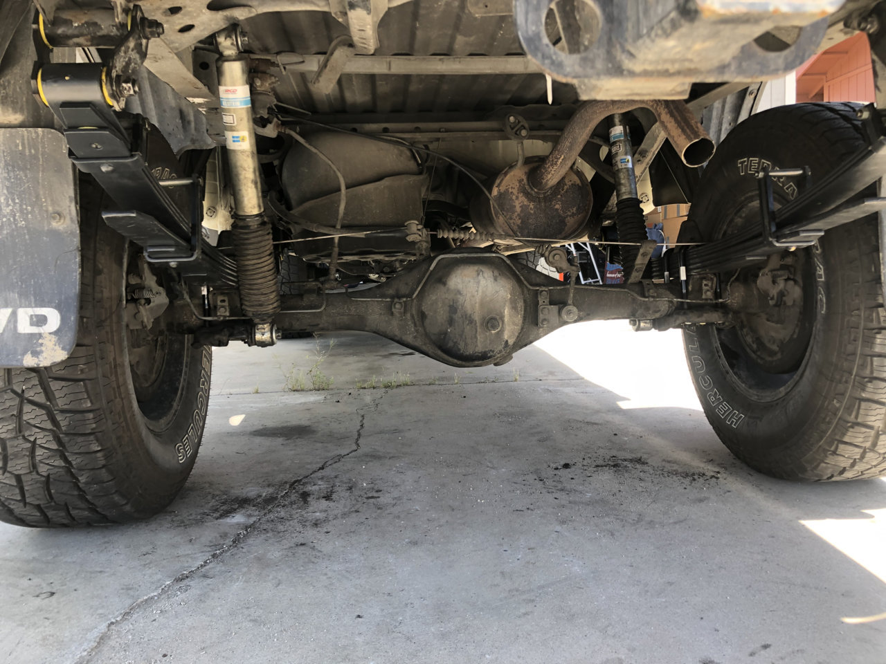

    Here's a photo of the Bilstein 5100s installed. Perfect fit with these springs. Just had to jack up the diff a bit to get them in.

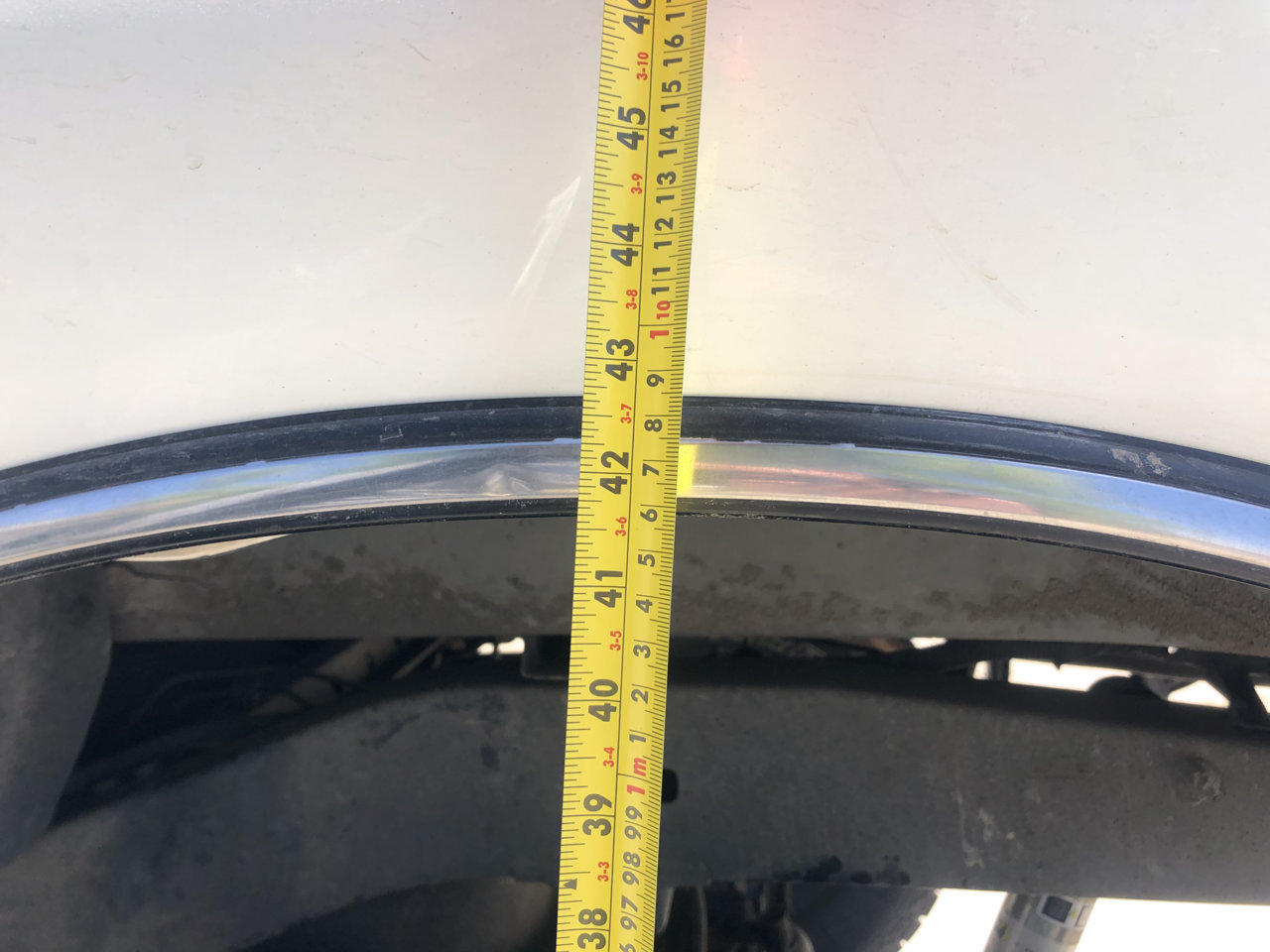

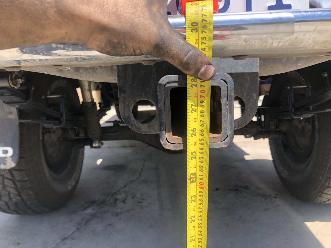

    Sitting at about 25 1/4" to the hitch and 41 1/2" to the fender! Much happier with it now. I took it off road right away and it was 10x smoother than it was before. I definitely need an alignment though, looks like my front passenger wheel is toed in now, and the wheel is turned left to keep it driving in a straight line

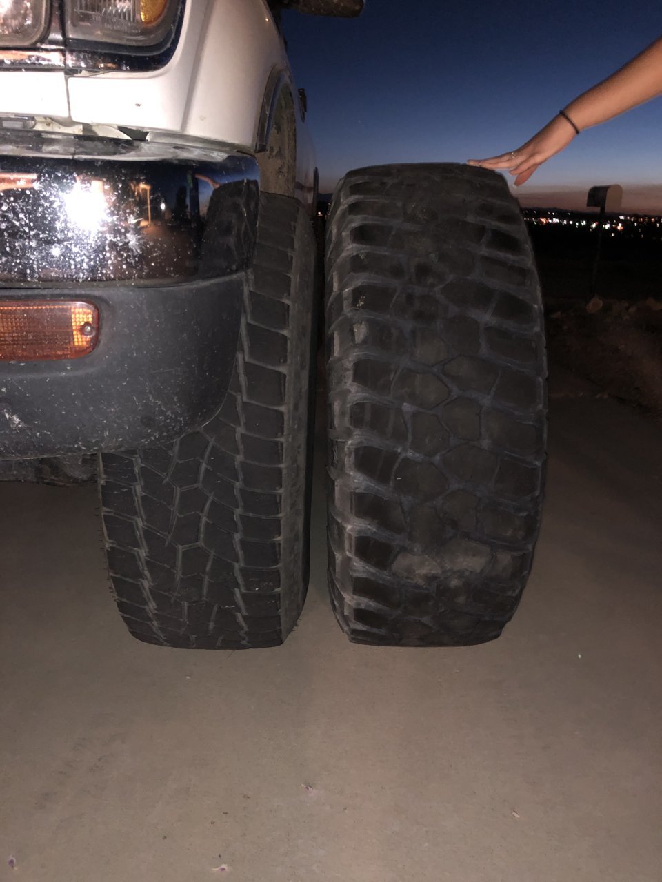

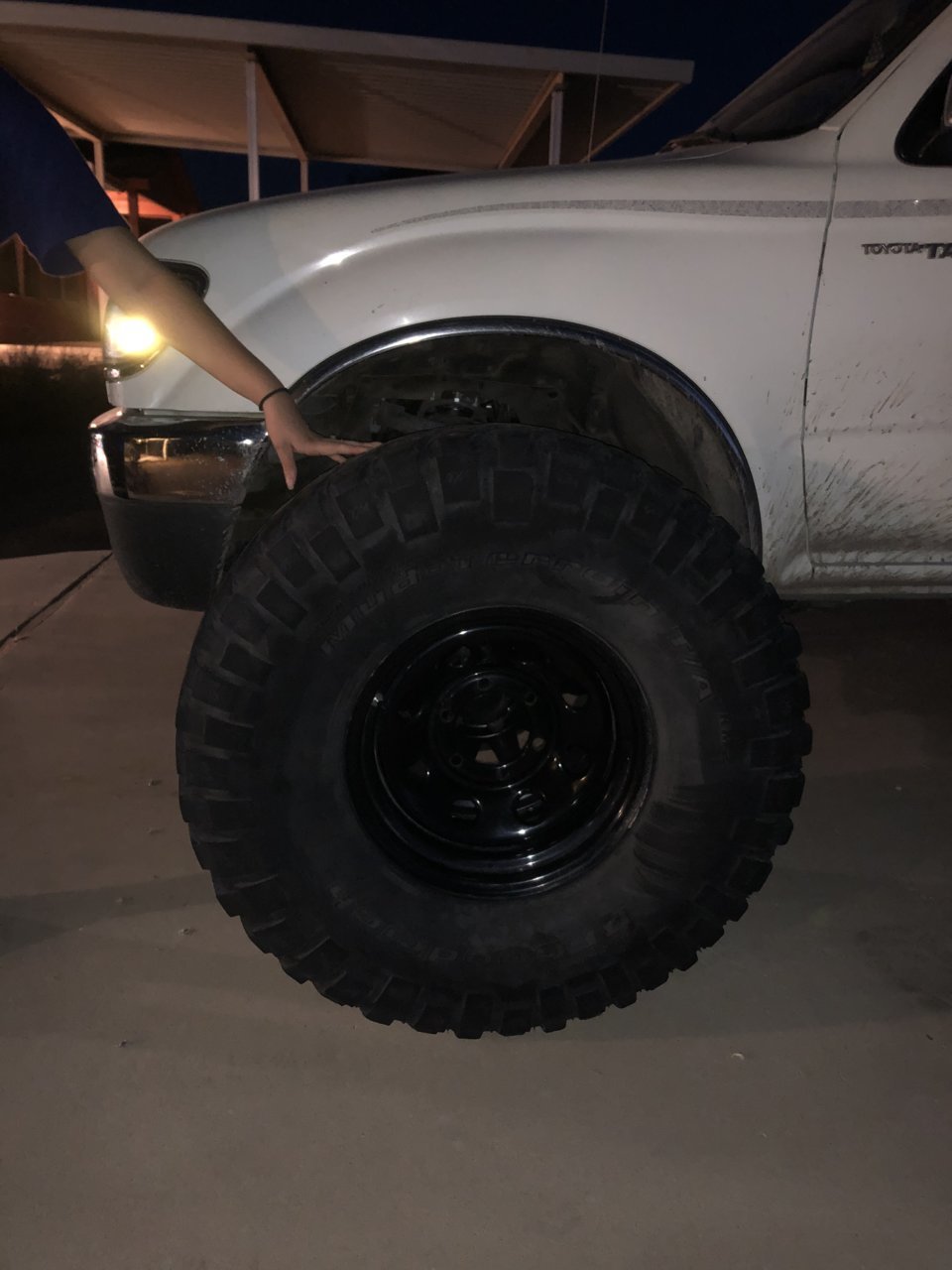

    Took her out for a few photos with the new lift!

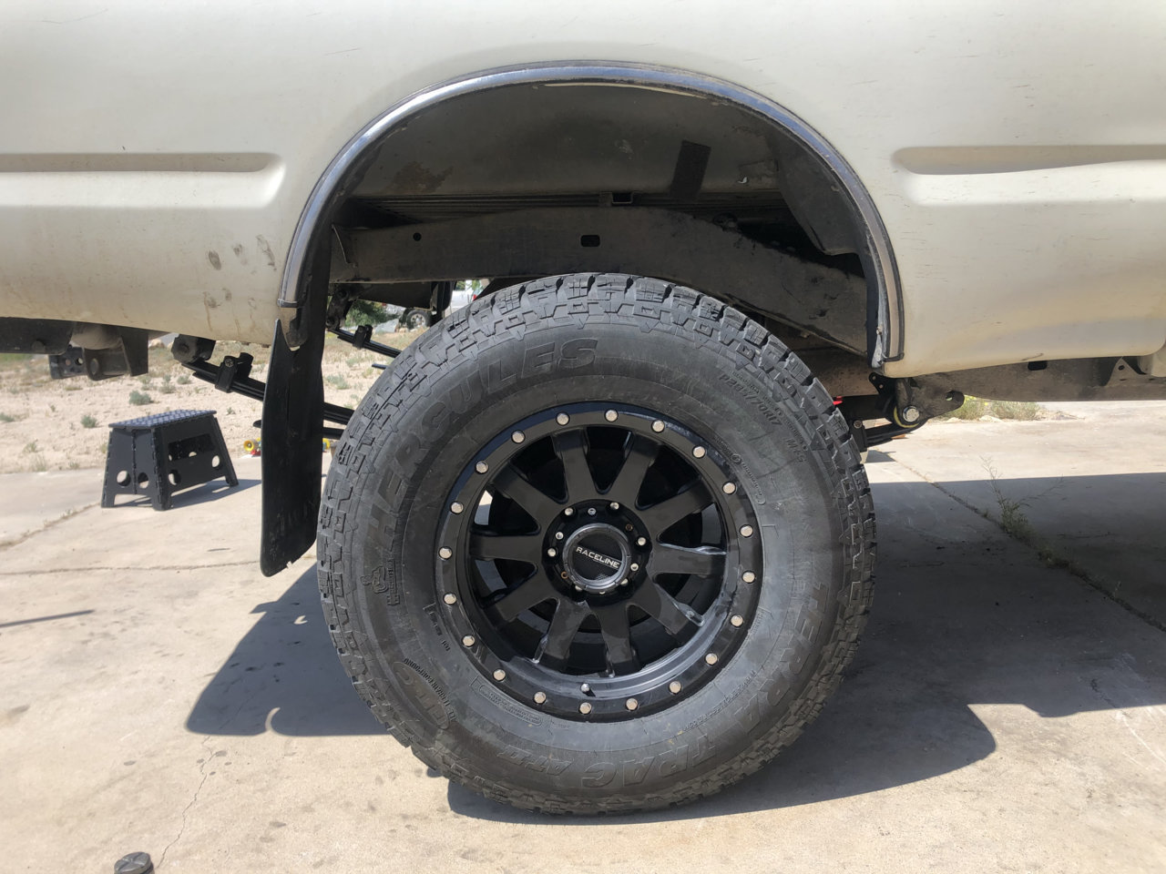

    E9DF1187-4DAA-4734-A468-DB792E6DE6BD.jpg 041ED965-E989-4D2F-95F4-85287AE58A85.jpg
    Got a great price on these, had to buy them! Time to start cutting...
