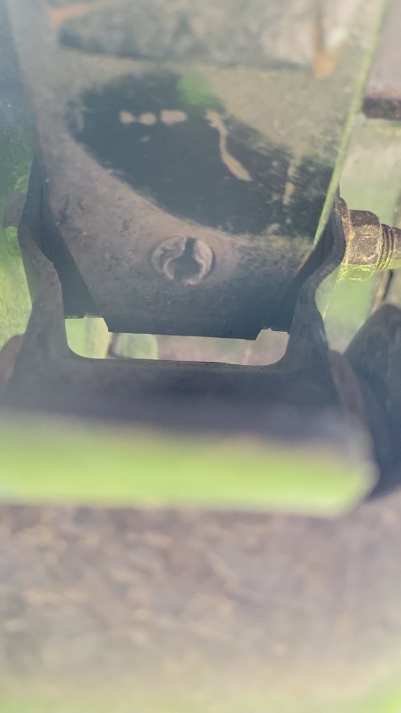

    Not trying to spread to misinformation here. Last I looked into this that was the case, granted that was a couple years ago (but not 6 years ago). Maybe that was just old stock but the 2nd leaf was definitely too long. I was specifically looking for this since I had the same problem with my Dakars.
    Do you have any proof this was changed? Pic of an installation perhaps? The pics of the leafs on your website (and any other website I can find right now) show the 2nd leaf just as long as the Dakars, ending right under the eyelet. Perhaps that's an old picture of them?

    Sorry, help me out here. What was changed? That still looks just as long. Was it just the extra taper on the ends? Does that not still make contact with the shackle when the leafs shift laterally?

    Those leaf springs have been on that truck for 3-4 years. No, they don't make contact, as you can see in that photo. The taper is what clears the shackle. The 2nd leaf needs to support the main leaf so it doesn't bend under super heavy loads.
