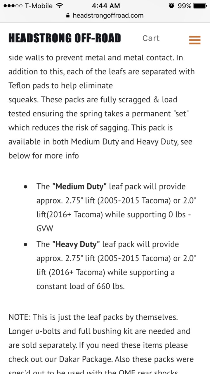

    I think you're definitely correct, as far as their website saying that. However, when I was doing my research for a leaf pack, I used only headstrongoffroad's site as well as lots of reviews from people online and in person who said the medium duty packs couldn't handle any weight at all and that's why I chose the HD packs. It's unfortunate that websites are adrvertising the MD pack as being rated for any weight.

    Yeah it always so confusing especially when getting info directly from manufacturers is so hard. Idk. Its handled "some" weight just fine. But I'm afraid to add anymore. I would like to add the leaf to convert to HD, but ughhhh, that job is such a bitch.
