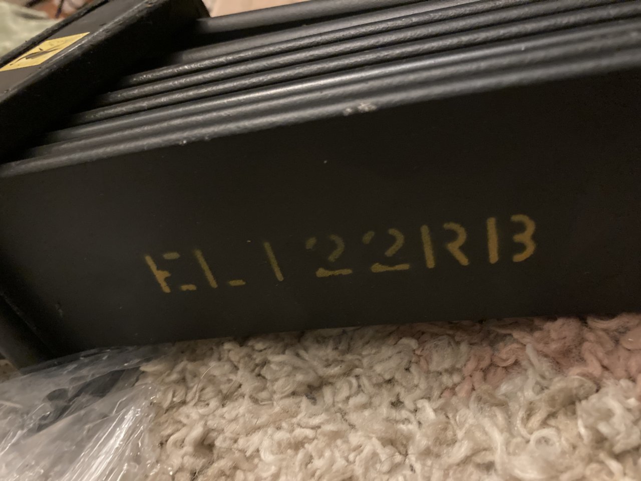

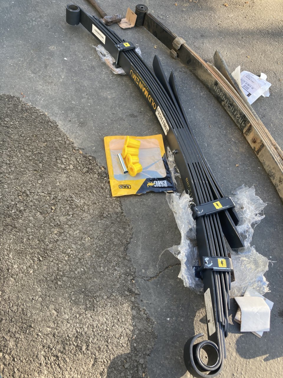

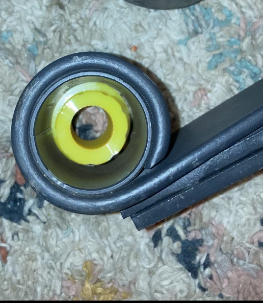

    Ordered ome leaf springs with AAL and two sets of ome bushings through wheelers off-road. The leafs did not come with bushings pre-installed and the ome bushings don’t seem to fit correctly. Is the negative space between the bushing and the eyes of the leaf normal? Ome bushings also only came with 1 sleeve per kit... What am I missing here? Appreciate any feedback, thank you all :beavisd:

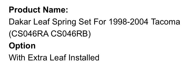

    Abeyancer Not so secret, secret van guy

    98 4x4 ex cab tacoma 3rz
    Subbed for response, I was about to pull the trigger on this kit

    Yah they sent me the wrong part

    Here’s the part# they sent me, refer to original post for the part# I ordered

    The bushing kits I orderd for CS046R arent listed for EL122R but I should be able to use the springs if i can find compatable bushings ?
    bushings i orderd---------->ARB-OMESB89 Old Man Emu Shackle Bushing Kits for Single CS018R, 19R or 46R Leaf Spring (SB88 or SB89)

    damn im a jackass took the leaf out without making sure i had the right parts in hand. Yup trucks on jackstands :anonymous:

    Wait. Dont buy anything because now what im reading on their site doesnt make sense... Dakar Leaf Spring Set For 1998-2004 Tacoma (EL122RA EL122RB)
    Application Data
    1998-2004 Toyota Tacoma
    NOTE: ARB-OMESB121 bushing kit required, sold separately.
    ___________________ Old Man Emu Shackle Bushing Kit For EL122RA/EL122RB Springs
    Application Data
    TOYOTA TACOMA
    (1995-1997)
    1995 Toyota Tacoma
    1996 Toyota Tacoma
    1997 Toyota Tacoma
