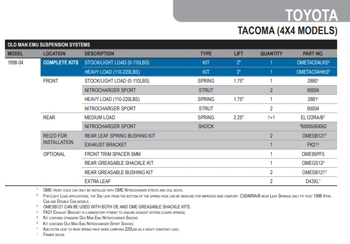

    Contaced wheelers and sure enough theyre out of stock on the correct bushings (omesb121) and atleast 2 weeks out. Wheelers off-road shifted the blame to ARB and explained how they didnt receive specifications on the newest version of the leaf packs (EL122R) but decided to ship them out anyway...:confused:

    Looks like there are updated part numbers for new Dakar leaf packs & corresponding bushings for 1st Gen Tacomas. The updates do look good (especially if it alleviates squeaky leafs).
    But ARB/Wheelers would likely still stock the old bushing kits for some time in order to support all the CS046 leaf pack owners out there. So I guess you got stuck in the middle and received the new packs and the old bushings.
    That really sucks, but it sounds like they did everything they could do to correct it by sending out the new, correct bushings ASAP on their dime. It's just that nothing is in stock because it's all stuck in containers somewhere. Same thing applies to ALL things mountain bike-related this year- I'm a bit worried about when I break something and need to replace it this summer.

    Cleared the weekend to install my OME leaf springs. Bought them from an ebay seller. Their ad says CS046RA and B. I confirmed with them the part number so I ordered from Wheelers all the right bushings for the 46R including the front main eye bushing. The leaf springs get delivered and they're EL122R. Wtf?
    I'm deciding if I should keep the leaf springs and wait for the right bushings or return the leaf springs and get the CS046R. I can get the CS046R immediately off a private seller.
    That Ebay seller really messed up my weekend..
    Does anyone have a review of the 46R vs the 122R?

    Every vendor seems to be shipping the 122R in place of the 46R, so I'd venture to say they are incompatible for our vehicles and should not be installed no matter the circumstances. :bananadead:
    (/s, this is sarcasm, sorry if it wasn't clear enough)
    Vendors are still selling the old bushings because they are a consumable item, and like any manufacturer worth their salt, they will continue to produce the consumable items for a time after the main product has been discontinued.
    Unfortunate position that no vendor has the intelligence from manufacturer to update their listings. But I'd wait and get all the newer stuff and test it out.

    Not sure if I follow exactly.
    But I double checked with the seller to make sure these springs were the CS046R and they confirmed that they were.
    People might ask why go with the 46R if the 122R is the updated version. For one, I have the bushings for the 46R already. Second, I can get the 46R springs immediately used. The only remaining question is, are the 122R springs a lot better than the 46R?

    I have not seen a post or review yet that addresses your last question.
    The assumption is the springs almost every vendor is now shipping (122R) (((they are probably drop-shipping))) is an updated version of the leafs for select models of 1st gen Tacomas (the same models as the 46R)
