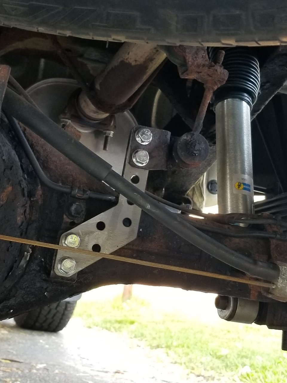

    So my brake line doesn't look tight at all..
    Finally have my proportioning bracket thingy..

    Its when your rear end flexes is when the brake line gets too tight. It will look fine at ride height but you should flex out the back end to see how tight it really is.

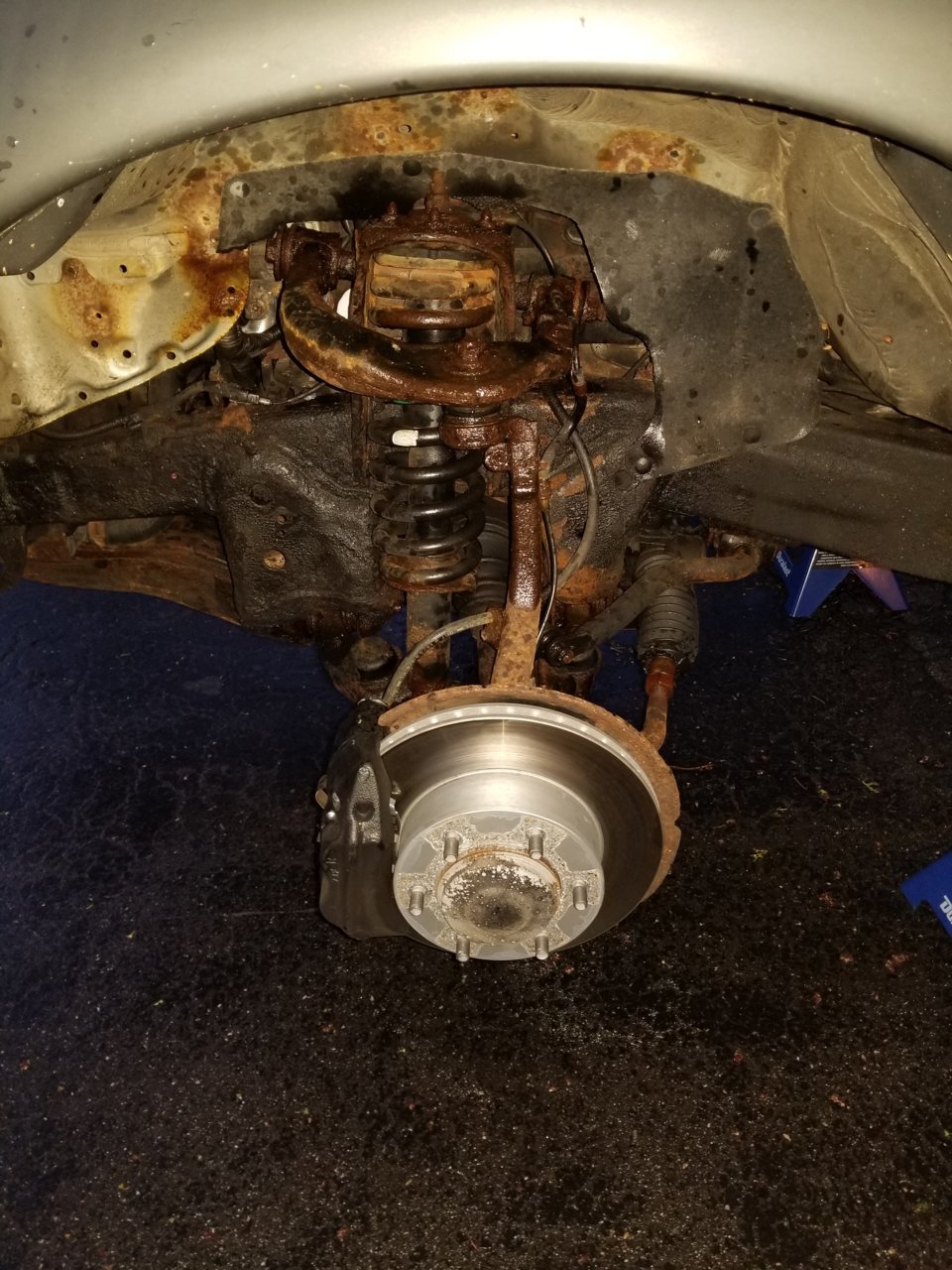

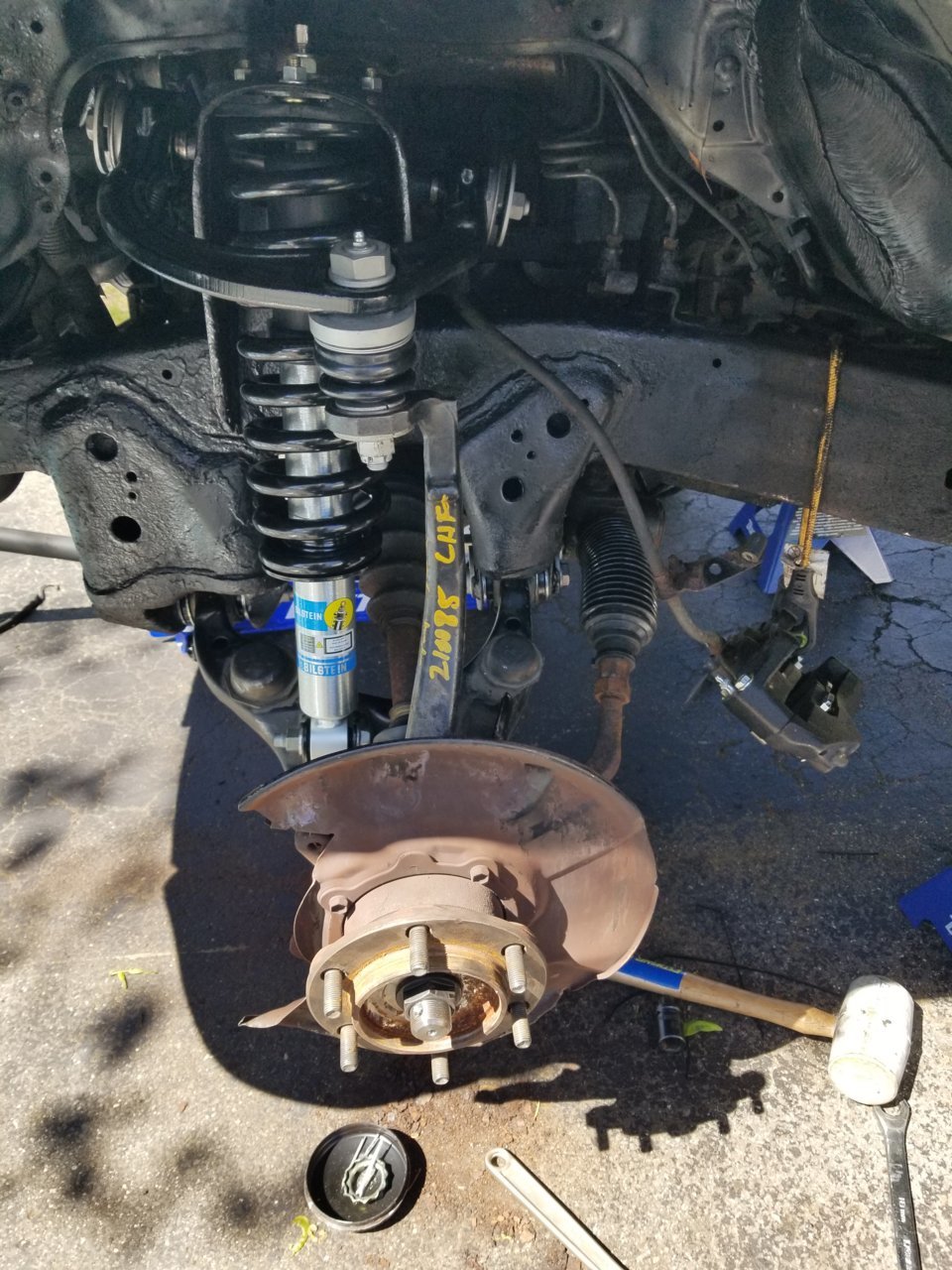

    Haha. Welcome to new england? Just redid my fronts and it was rough.
    Slowly in time I'll get to everything..
    Yes, my spc bj is backwards in the photo. Lol

    Okay, the line is still on it's way so I'll change it then. I mostly commute so no worries about major flexing
