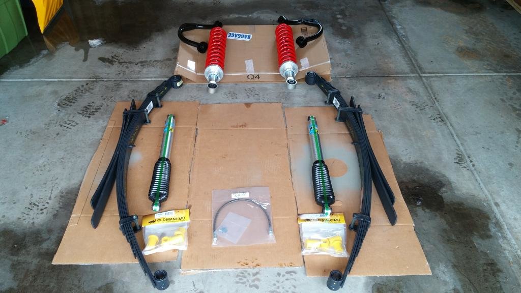

    I'm in the middle of my install right now, having a shock/bushing issue (bushing on the new shocks are too small, 16mm...need 19mm)
    but by tomorrow I hope to at least have the new leaf packs in.
    if you look at the picture, mine came with an arrow, pointing towards the front (top of pic) and shop told me A & B referred to driver's (A) and passenger (B) its at the tail end of the part # CSO46R(A or B)
    if yours aren't labeled with the arrow, look for the bracket holding the overload springs, mine are situated forward of midline
