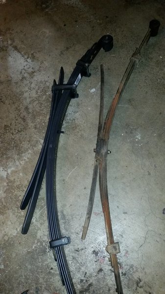

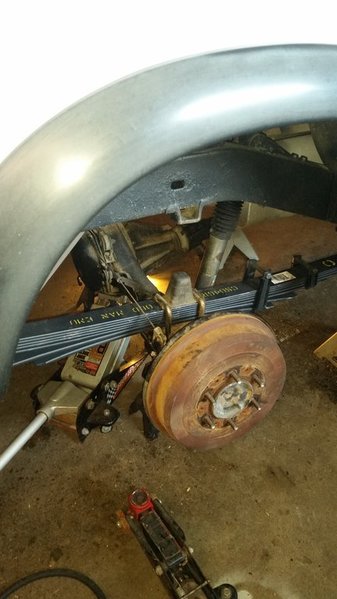

    Just installed new OME leaf springs and threw out the old leafs with that cheap add a leaf what a difference i should have done this first time around....cost about $400 for leaf springs and bushings and a little exhaust bracket this is a must over a block or add a leaf guys!!!

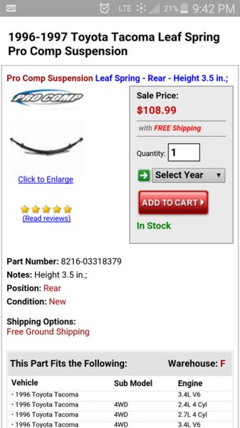

    As I understand, Dakars are only made for the '98 and up trucks? What is the equivalent for the older tacomas? My clapped out '96 needs springs. I know All-Pro and Wheelers offer some, but which crossover to being just like the Dakar?

    Someone has to know about the 1996 97 i juat found this for ya on line but ya i dont know about it being like the dakar springs...

    they include the 5-leaf in the OME package for 95-97

    Well i have the bilstine 5100 on the back and the bilstine 2.5 lift on the front so with the new leaf springs it feels very solid and can take a corner alot better now off road or logging roads i cant say yet... but around town feels great to me and now im about 1" higher in the back but looks fine also i bet it will settle abit after a few months...over all o am very impressed and i do not regreat it at all
