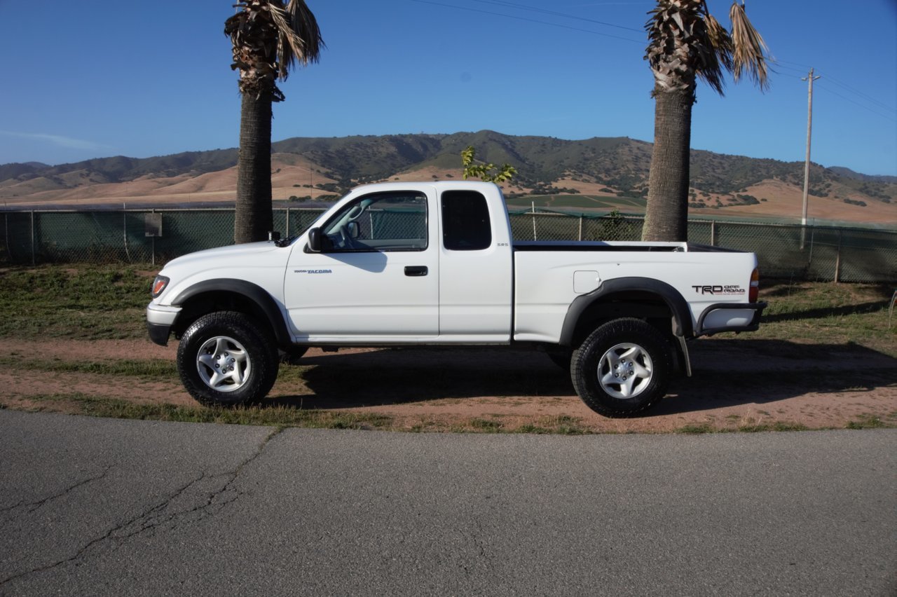

    Here's an example -

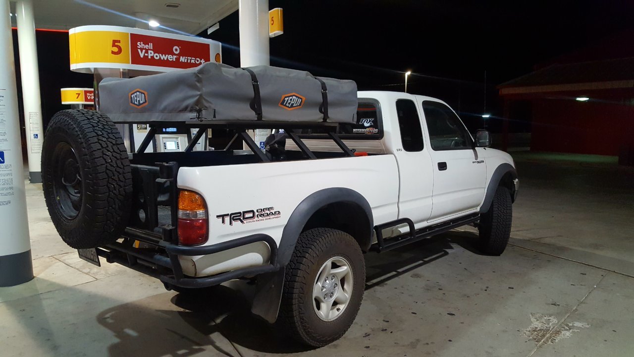

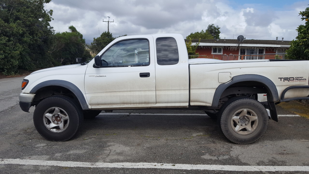

    And about 2 thousand miles later -
    Even with additional weight, it doesn't sag -
    Hamer95USA likes this.

    Oof, pictures too dark

    I took those pictures at a local grocery parking lot in the evening. The fires in northern California were going on and the air was smoky.

    No worries, first one looks like it was taken with a potato
