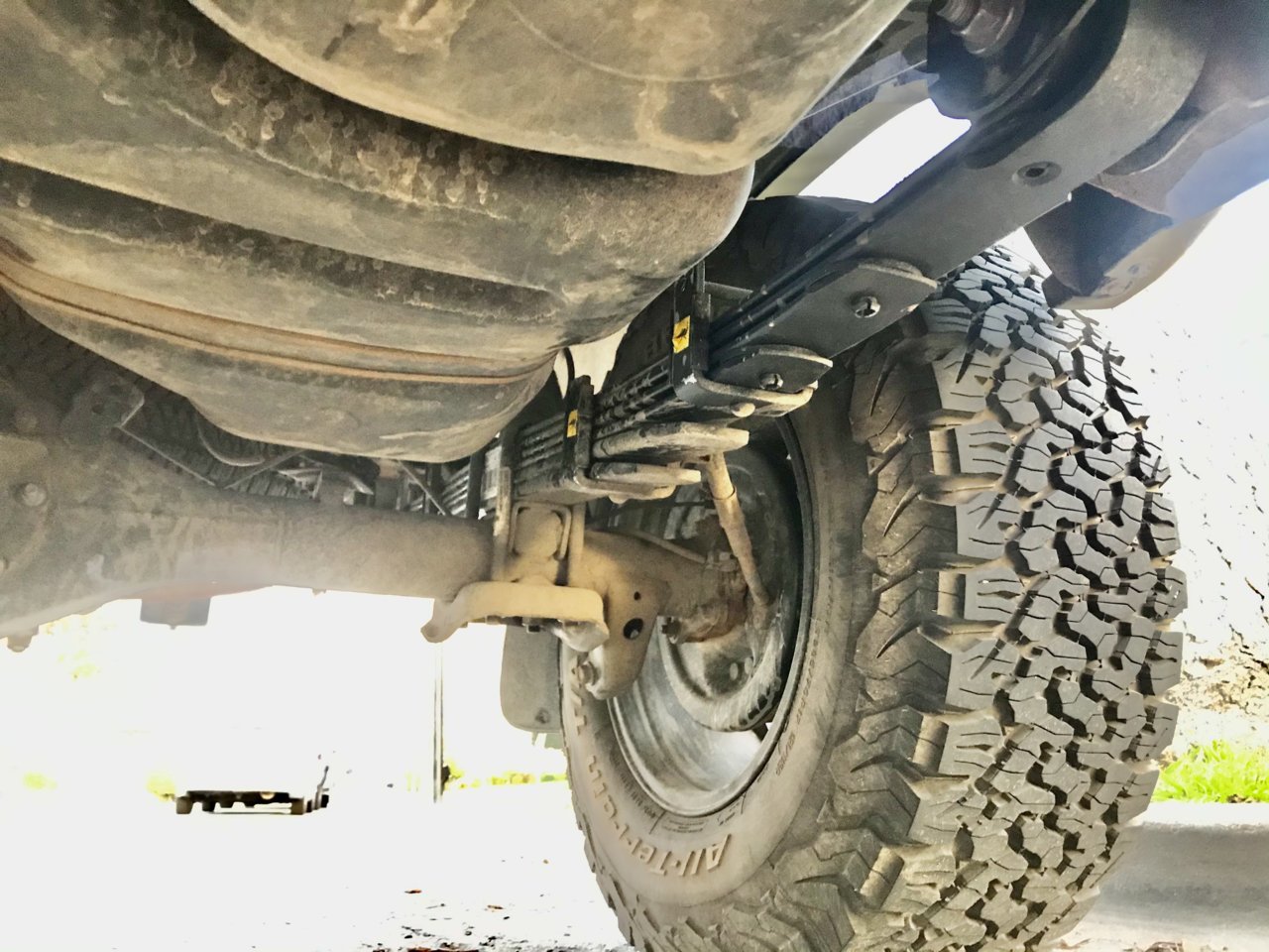

    Now that the mediums are on I realize I’m still nose up a little bit because of the lift of front and that’s only going to get worse with weight in the bed and settling. It drives great and feels really planted so far but I ordered the additional leaf to get another .5 - 1 inch in the rear. Why do some people not like these springs yet half the people on this forum have them? Lol
    Definitely would be squatting a good bit until the other leaf gets here so we’re not putting the bars and tent on it yet. What is it you don’t really like about them?
    I actually still have the Fox shocks in the rear with the new leaf springs until the kings for the rear get here too so the setup is a little wonky right now. These things way smoother already than the stock pro suspension ever did. The suspension for the pro is pretty underwhelming honestly but all the other pro stuff was worth it for sure

    Installed my MD Dakar’s. Getting my W on. Only have a 80lb shell on the bed.

    That’s a really good looking setup you’ve got there. I’m glad you don’t have any issues since it seems like a lot of other people say theirs are laying flat which is pretty discouraging. At this point I realize Heavy would have been the right move to begin with on a third gen.
    this is how it’s sitting now which I’m pretty happy with besides the missing inch in back haha. The ride is extremely comfortable compared to stock though. And this is with stock Fox shocks in the rear still

    Is there a reason why that would be happening with only 80lb on them? Are you going to add a leaf now?

    Im not sure... Seems like I might have to once I put the tent on top and load it with gear.
