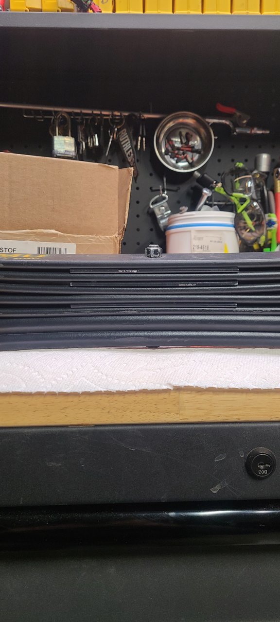

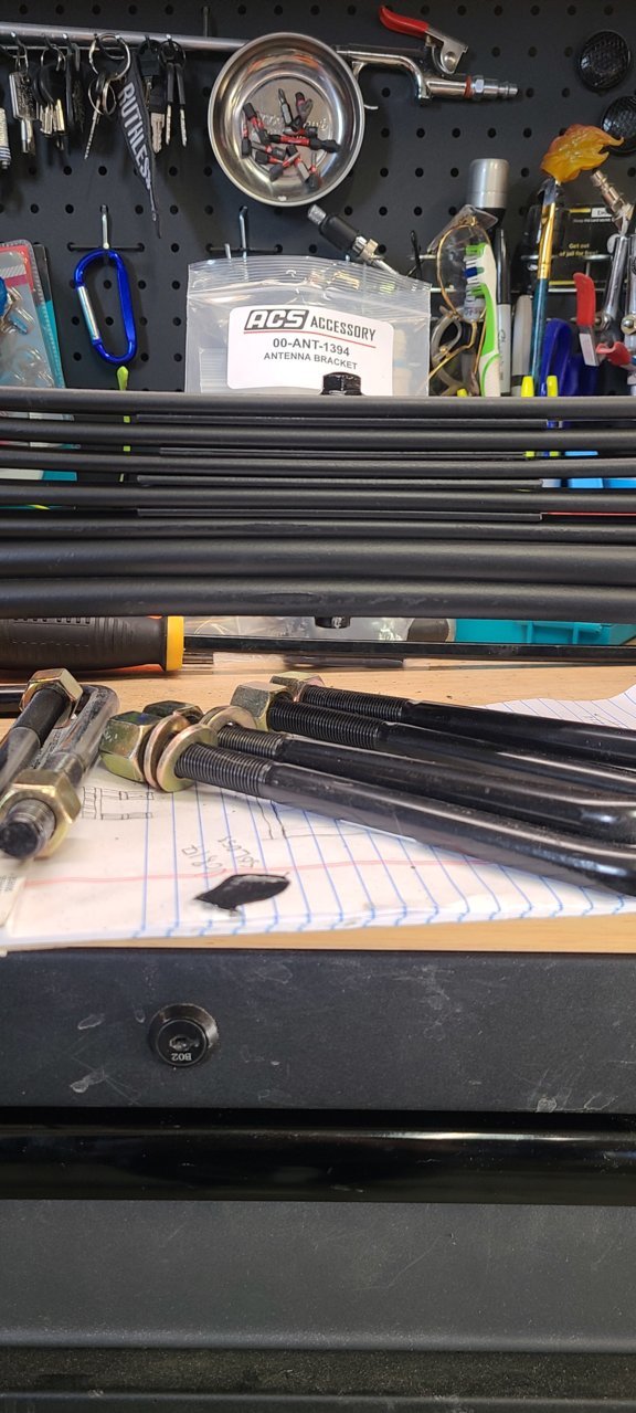

    I'm installing the el46xls on my mediums right now.
    Was I supposed to get an additional steel shim/plate for in between the springs?
    If no, do I put the existing shim below or above the el46xl in the pack?

    What I did was take the shims from my stock leafs and put them in there. I’d like to know too because I’m adding another leaf and I think I’m out of shims

    I think I'll do the same! I did just get done assembling them without the shim though... I'll call ARB on Monday and update what they say is proper.

    The only thing is that they are a different length from the dakar ones. Hasn't caused me any issue though and I have thousands of miles on mine

    You sir are correct.
    I don't see it being an issue either.
    I do wish I would have put the shorter ones under the top spring though.
