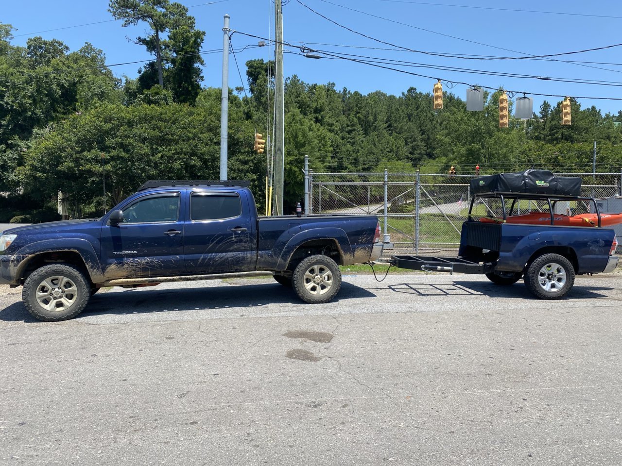

    If you're stuck on OME, you can turn the Med into HD with an extra leaf if you decide to. If you're still able to go with another company, I'd highly suggest Dobinsons. I have the 111's(med) on my camp trailer(they are spring under with no shocks right now) and 112's(HD) on my truck b/c I have a decked system and camper shell sometimes, with plans for a Brute Force HC rear with swingout. @Crikeymike has great CS and will walk you through the options.

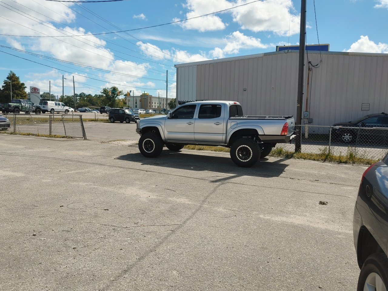

    0701211605a_HDR.jpg almost 4 inches of rear lift going strong for over 2 years.

    Actually you had the HD's and i made mine the HD+ Pack. Ive got 2 add a leafs in there lol.
    [​IMG][​IMG]
