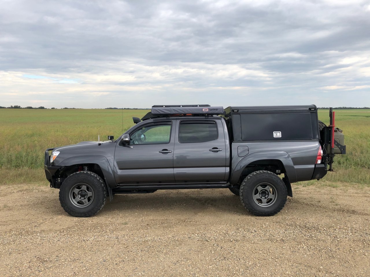

    Sna
    Sna Well-Known Member
    Mar 21, 2015
    #151425
    1,395
    Alberta
    ‘15 trd sport 6MT dcsb, mostly stock?
    Dobinsons super heavy duty 112-R leaf pack with their 113-R add a leaf. This got me my rake back and wow does it handle the weight better than my Dakar CS047R leaf pack with the D29XL add a leaf. Same number of leafs but the way I’m sitting now almost fully loaded is the way I was sitting with the above Dakars when I was completely empty. I don’t have new profile pictures yet but will get some this week.

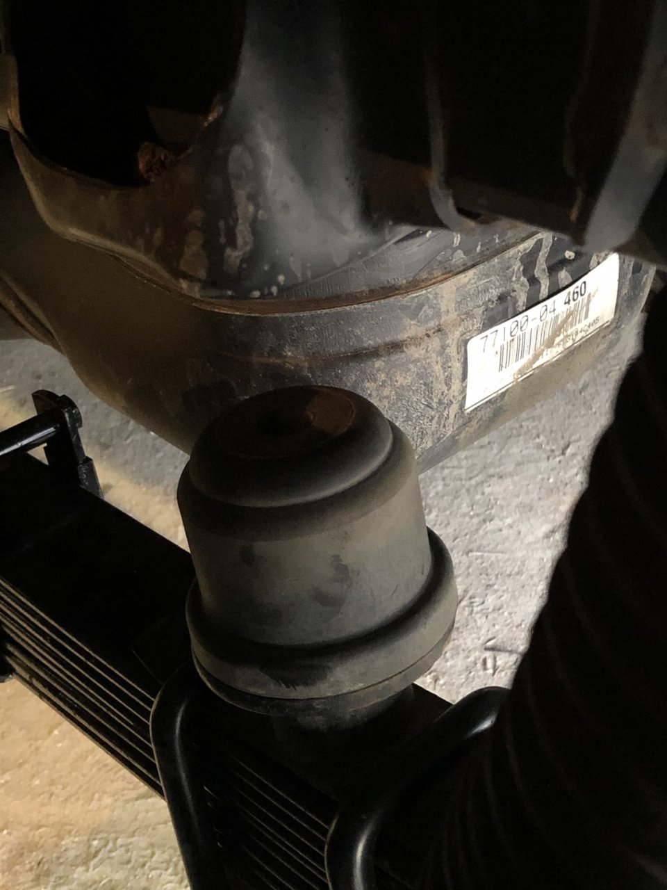

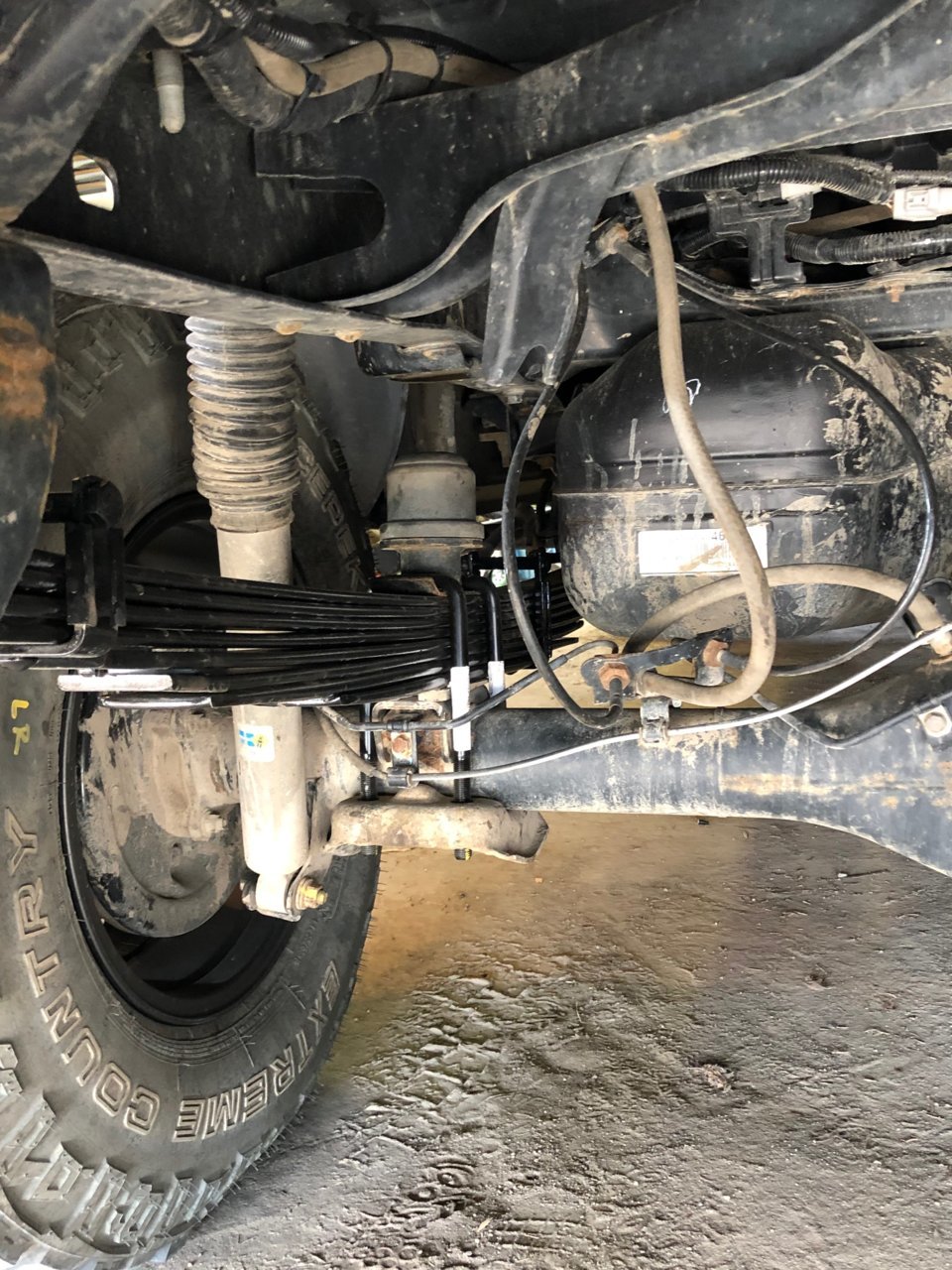

  9. Aug 12, 2021 at 4:48 PM
    #89
    Sna
    Mar 21, 2015
    #151425
    1,395
    Alberta
    So much better....
