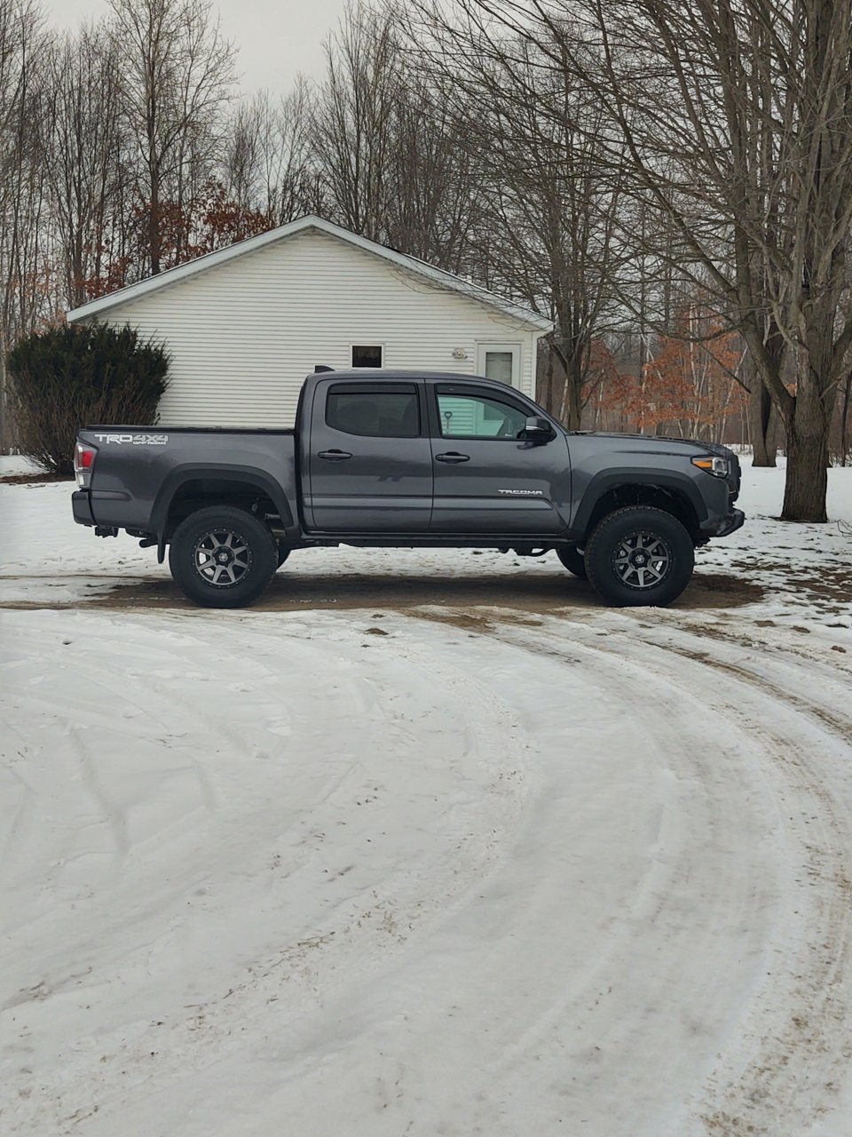

    That's a good kit. Talk to Steve at Wheeler's, he gets it right. If you're going 285's stay with a 0 offset wheel and get quality UCA's. Make sure your allignment guy gets at least 3.5 positive castor. I have 3.8 and after I did that I can even clear my mudflaps with normal use.

    That’s a clean looking taco especially that MGM;)
    I’m carrying around a constant 200lbs in the back so I’ll give them a call to see if I need the expedition pack instead.

    I'm not sure but I'd say my tonneau and bedmat weigh close to 100lbs. I read in your thread you're looking at icons. They're a really good leafpac. I was seriously considering them myself. I think they will do a little better with a load than the allpros but I understand they're a little stiffer and rougher riding with no load. Either way, call Steve and discuss it with him. I think he sells both. Hope this helps.

    BTW, did you have any taco lean after the lift?

    I set the 6112 clips on 5 and 5. I used a 1/4" spacer for the lean. I figured if I needed to adjust for lean it would be way easier with small spacers. Worked out pretty good. No lean. Got a solid 2 1/2" in the front on those settings and they've been on for around 1000mi and almost 2 months.
