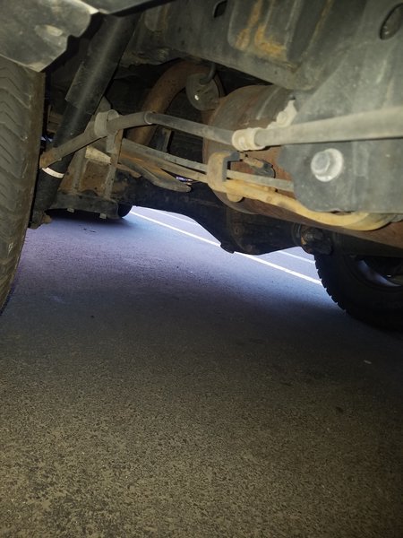

  16. Mar 7, 2017 at 4:24 AM
    #16
    localonthe8s
    localonthe8s [OP] Active Member
    Dec 28, 2016
    #205941
    39
    These are my stock leafs, do they look unusually flat? There's only 30k on them
  17. Mar 7, 2017 at 4:47 AM
    #17
    spiralout462
    spiralout462 Well-Known Member
    Sep 16, 2012
    #87068
    1,792
    Eastern Shore VA
    2015 4x4 dclb
    Icon suspension '15 toyota nav TRD FJ SE anthracite wheels Weathertechs Trd pro pieces
    I just replaced mine at 29,000 miles. Brand new, they don't have much of an arc. That's how they're made. Add 200 lbs, and they're inverted.
