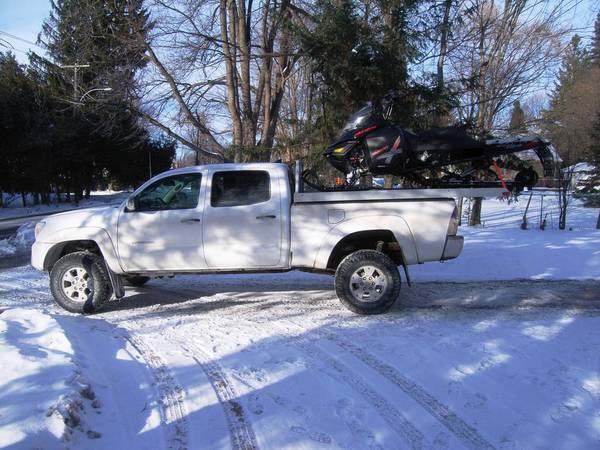

    I have already added the D29XL leafs in the rear when i added my bed rack, basket, rear bumper, and swing out. I like the way my truck is sitting right now but i am about to do a drawer system, jerry cans on swing out, camper shell, front runner rack, etc. Has anyone ever put 2 of these additional leafs into their pack? Is it even possible to do this?
  12. Feb 17, 2015 at 7:24 PM
    Imageoguy
    Imageoguy Well-Known Member
    Sep 16, 2012
    #87053
    212
    Gatineau, Qc, Canada
    2012 DCLB SR5
    Full OME suspension (885 front springs, Dakar leaf pack + OME shocks) + D29XL extra leaf + 3 deg. shim + RideRite airbags
    Not sure if that would be a good idea, I'm no expert but since additional leafs would be the same length, the pack might not flex properly. You could probably try airbags first, they worked great for me with my D29XL pack.

    I'll get better pics tomorrow...
