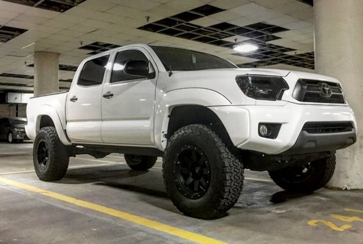

    do both and leave the 5100s at the zero setting. I run the 5100s with OME 887s. 1.5" AAL in rear with 5100s. Also replaced UCAs.

    Thank you for the info, really like the way that set-up looks in the picture. Also, what size tires do you have with that set-up?

    285/70/17 BFG KO2s with SCS SR8s

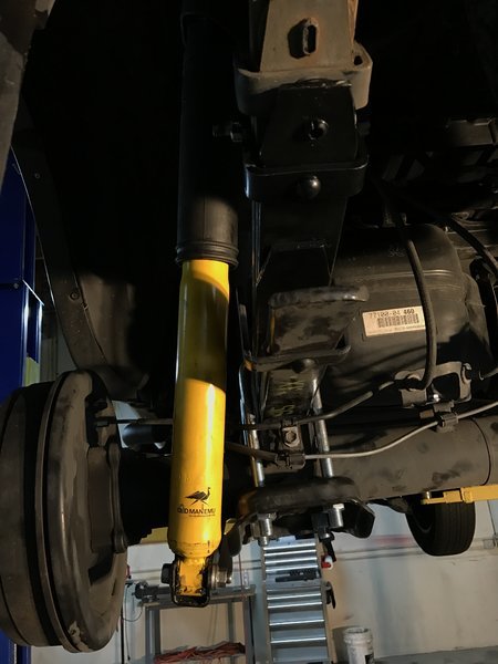

    OME is a solid choice, I just installed mine over the weekend and I'm very happy with it.
    887x coils with 90021 nitrocharger strut with HS 3 leaf AAL in the rear. Entire setup was under $1,000 and install wasn't terrible.
    Bad pics, but this is on TRD pro wheels with 275/70/17 tires

    3rd gen 5100 bilstiens set at 0 with ome 888s, LR UCA, 5160 bilstiens in back with icon 3 leaf aal with 1" block. Fuel savage wheel wrapped in nitto ridge grapplers 285/70/17
    Are the 90021 nitrocharger strut the bilstien shock or a diff brand

    Old man Emu

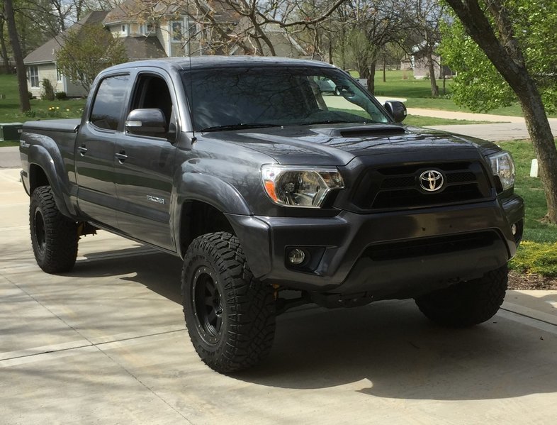

    3" lift OME lift 887 coils, LR UCA's, 16" Stealth Custom Series Wheels and 265/75/16 Duratrac Tires
    OME 887's, Sport Shock all around SCS SR8 wheel 265/75/16

    Looks good. What do you have for leafs? Stock?
