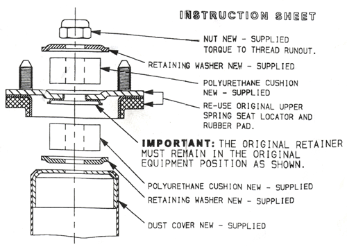

    L J
    L J Well-Known Member
    Mar 16, 2010
    #33339
    859
    Illinois
    07 4X4 SR5 TRD Sport DCLB
    Does this picture help?
    Hamer95USA likes this.

    I swear that I followed that diagram (still have it in my folder with receipts and such) when I assembled everything since I'm OCD with stuff I work on. I guess I'll have to take them apart to see what is wrong.
    Sucks but ya gotta start somewhere right. Maybe that upper spring seat is wallowed out or something. Good luck getting it sorted!
