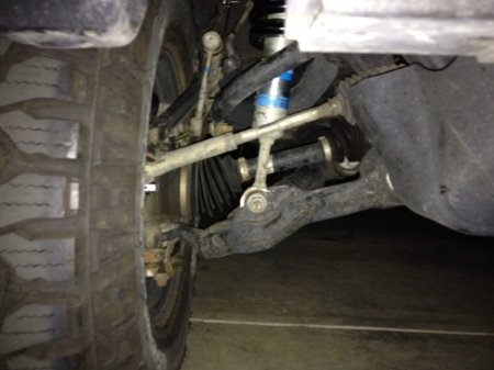

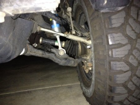

    Blowing up would not be good. I don't want to be on the news. Just snapped a few photos, will post soon.
  9. Feb 19, 2014 at 8:11 PM
    #49
    Okeetee
    Okeetee I like the Anaheim Ducks
    Aug 13, 2011
    #61638
    844
    Kyle
    Huntington Beach, CA
    '11 MGM TRD Sport DCSB 4x4
    OME 887 coil springs, Bilstein 5100s (front/rear), Light Racing UCAs, Wheeler's HD 1.5" AAL, 18x9 Pro Comp series 7032, Toyo Open Country A/T II (LT285/65R18)
    Pardon the blurry pictures. How do the CV angles look? Judging by the photos from other people in different threads, I'm thinking they don't look good right now.

    Wishbone Runner
    Wishbone Runner Because 4R
    Sep 9, 2012
    #86546
    6,220
    James
    CO
    04 SR5 4Runner
    King/Dirt King
    I have had this issue with my OME setup from day one, particularly noticeable in whoops where the front end wants to come off the ground. Really only one solution.
  11. Feb 19, 2014 at 8:15 PM
    #51
    OZ-T
    OZ-T You are going backwards
    Dec 15, 2009
    #27584
    50,461
    Peter North
    British Columbia
    Damn , UCA's are pretty steep
    Thats a lot of lift , lol
