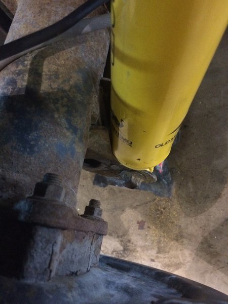

    During my install the rear shock on the drivers side is contacting the axle shock mount, will this go away once weight on wheels? image.jpg image.jpg

    I assume the shock is fully extended. if you want, take a grinder to the bracket and remove as little as necessary. Clean up any rust in the area and paint it.

    Ok thanks, we shall see once I get it all buttoned back up of need be I'll bust out the grinder! It would take me a long time to clean that rust up, working at it, very slowly

    So after everything was installed and set down, it still touches slightly, and in both sides, it also took some persuasion to get the lower shock in and aligned, has this happened to anyone else?

    yes, its happens, grind the shock perch to make it fit. Check out my build thread, post #14

    Thanks for the info, gonna do that tomorrow!
