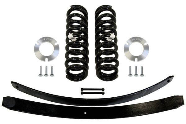

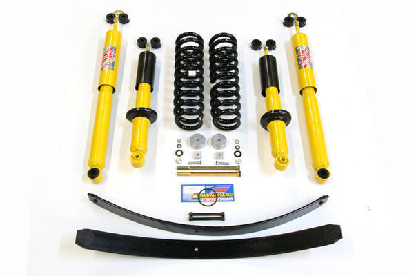

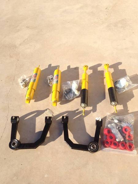

    Ok so here's what I first installed on my truck which I ordered from Toytec about 3 yrs ago and had installed with the stock TRD bilstein's
    Here's the upgraded shocks and UCA's which were installed almost a month ago.
    And here's a picture from Toytec's website. It looks as though there's more parts in the middle of the picture as compared to what I have. Although I ordered the trim pack I never received it or was charged for it. Could it be I'm having issues due to the spacer kit being different?

    those parts are actually the differential drop kit that comes along with the lift kit from Toytec.
    I just installed the OME setup and the ride is amazing and getting better all the time. I think if you're feeling like something is "wrong" because it is so stiff, then don't dick around with cheap, find someone who know what they are doing to fix it and don't fret the cash or you just might pay much more in the end.

    Does the OME kit come with new front bushings and washers? In the picture they appear to be there but they did not come with my kit I just got.

    It appears that it should but I noticed that the bushings on my truck right now aren't new, they are the old ones reinstalled. Maybe the guy ate them with his lunch.
