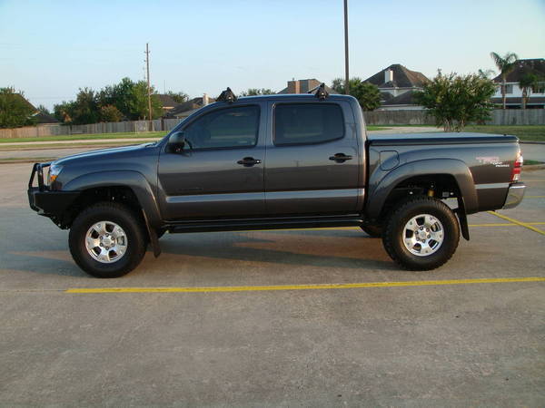

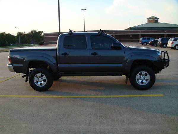

    I finally got my OME complete lift installed yesterday. I want to thank my friend Bakerla (TW member) for helping me throughout the whole entire process. We worked for a good 8hrs in 100 degree heat. I couldn't of done IT WITHOUT YOUR HELP.
    THANK YOU!!!!
    Now my measurements after the lift is:
    driver's front 23 1/2 inches
    driver's rear 25 1/4 inches
    passanger front 23 1/2 inches
    passanger rear 25 1/4 inches

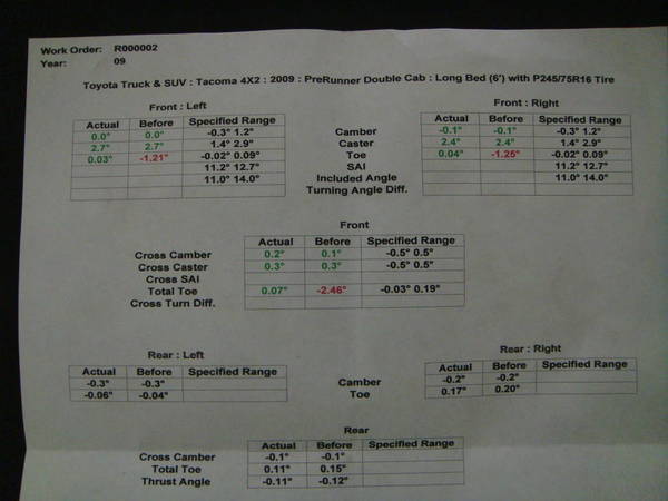

    and did the alingment this morning. here's the specs for the alignment.

    You use top plate spacers ?
    885 or 886 ?

    Looks good.
    no top plate spacers, as you can see in the pics.
    pretty sure they were the 886 coils

    Thanks
    Somebody else today posted a pic of 885 coils that they said had a 1/4" top spacer and I couldn't see it in a similar pic .
    Must be the 886 coils then , the measurements are higher than my 885's

    true, the 1/4" top spacer is hard to see. i thought you were referring to the 1/2" top plate spacers.
    he has the OME trim packer on the driver's side though. of course, that's not visible in the pics.

    without that trim packer i would be 1/4 inch lower on the driver's side. right now the driver's side is even with the front left.

    Nice, I also went with the Dakars. How much lift ? I got 4" also I got the same sheet from NTB the toe like yours was off. The sheet also had SAI & Included Angle #'s. Any squeeks from the Dakars? It looks great, nice work.:D

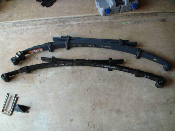

    If and when your Dakars start to squeak there is a fix , I already told hoofstomper
    http://www.tacomaworld.com/forum/suspension/156353-squeaky-dakars-any-advice-others-dakars.html

    rear brake lines look a little stretched. it's ok on road, can't do any serious offroading. i will be swapping them later on.

    OP , did you get the extra leaf with the Dakars ?

    NO extra leaf here.

    You got 3/4" more than I did when I installed my Dakars
    Interesting
