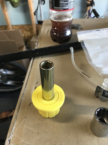

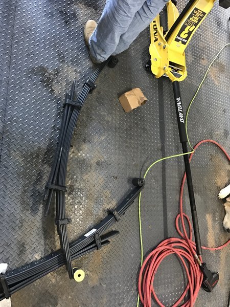

    Alright folks I'm mid install on my dakars. I've got 8 individual shackle bushes but my leaf springs already have black ones installed in the front of the springs? Where do the other four go? Also, do you just grease the internal metal bore where the bolt goes through?

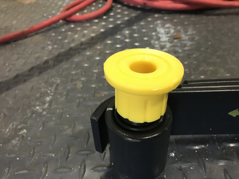

    I would hammer out the black rubber one and put the bushes there. Synthetic grease everywhere the poly touches metal. Inside, outside, everywhere.

    That's what I wondered but they almost look too big, does the metal around the bush hammer out too?

    Listen to @Crom . You got the extra set of poly bushings (I'm assuming from the same vendor you bought the leaf pack from). They're an upgrade to the standard front rubber bushings for sure. Had I done this when I was doing my install, I wouldn't be having to pull the leaf pack out to replace them now almost 1.5 years later. My rubber bushing on the driver's side has started to wedge itself out to one side and it the cause of an obnoxious squeak. The leaf pack itself has been surprisingly silent.

    Yes, the sleeve should come out as well. You should have just the leaf spring eye once you have the old bushing out. Basically should look like the rears did when you got the pack.

    Roger that. And greasing the inside and outside of that internal bore? Yes, I know it's upside down lol

    The rubber one has potential for being unstable in the eye.
    Hammer it out. Easy.
    I recommend Prothane Super Grease. Orders better than any syn grease on the market.
    Grease everywhere the poly touches metal.

    I would grease everywhere contact is made and movement is expected. Might be overkill and some guys say not to grease the outside of the new sleeve (inside the bushing) but none have given me a good reason why.

    I think Dakar just redesigned their packs and ditched the crappy rubber bushing... At least that's the conclusion I'm drawing from the pics I saw earlier this week.
    And the bushing does can and will move in the eye.
