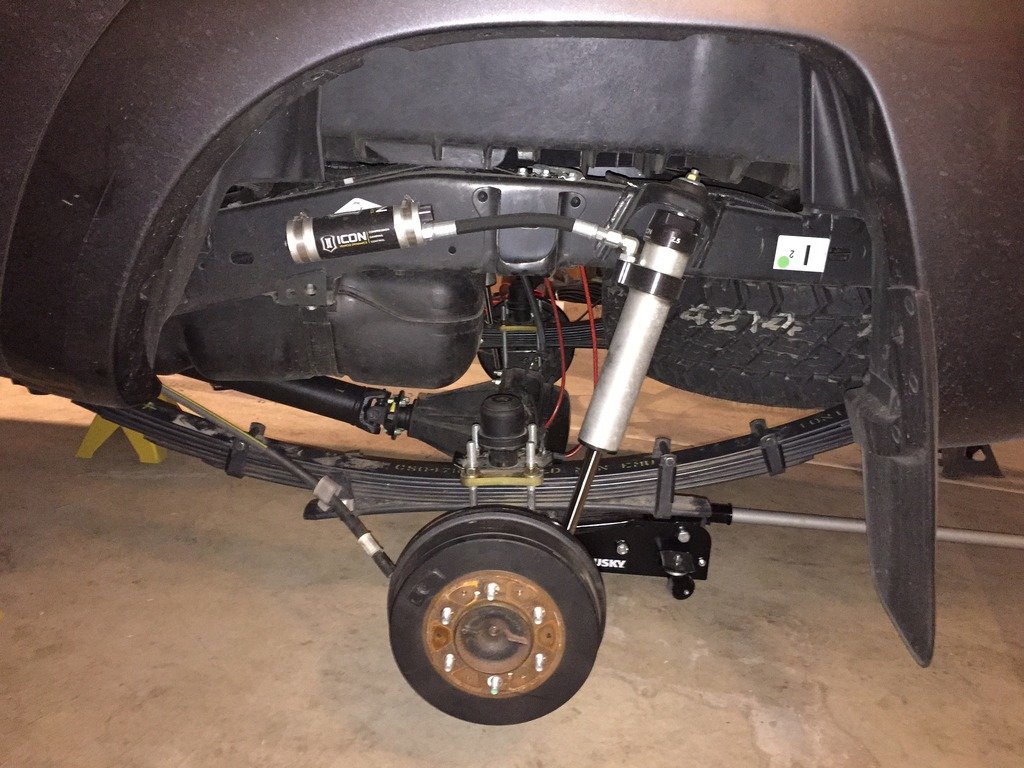

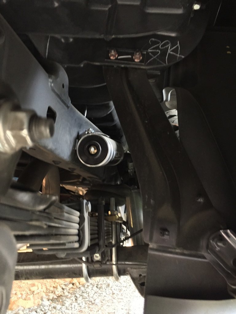

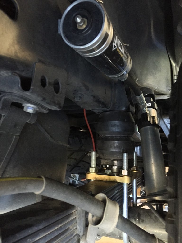

    Add the extra leaf and remove the large upper overload. It will increase ride height a small amount and be more progressive. That long overload really acts as a bump stop almost. Additionally the OME shocks are probably too short in back. The dakars can support a 26" long shock. Add either timbrens or superbumps and space them appropriately for the longer shocks. You'll need longer brake lines in back too.
    I like my icons but opinions on coilovers will vary. Any of the good coilovers should prevent the harsh topping out. Go for extended length since you already have the upper arms. If you run icons I'd recommend the 700lb coils for sure. Additionally, adjust the coilovers to leave at least 3" droop from ride height, this will drastically improve the ride vs preloading them and leaving little travel.
    My rear end (dakars with extra leaf, upper overload removed, flipped u bolts, wheelers super bumps and icon shocks). The shocks are 15.85 collapsed and 26.18 extended.
