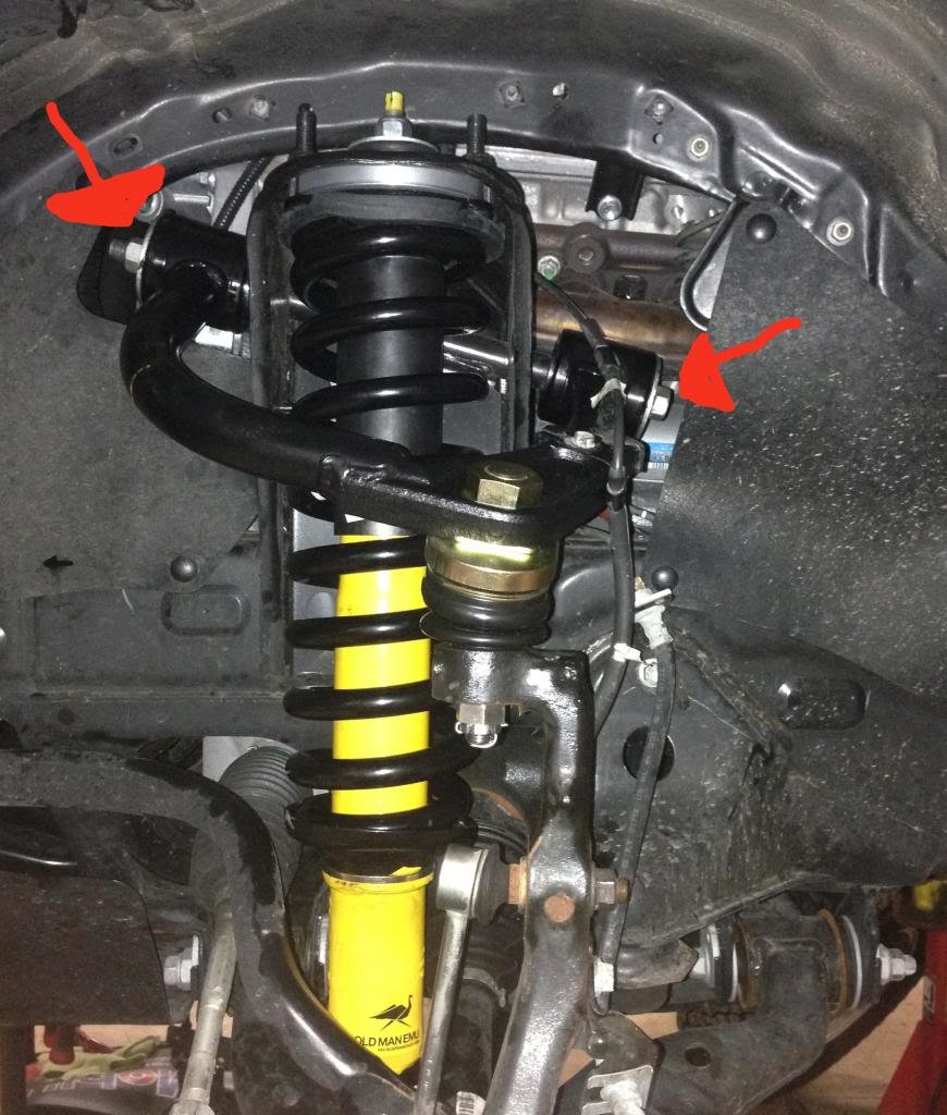

    - UCA bolts were giving us issues has to bend a little of the inner fender metal and remove the brake line mount on the driver side and we put the bolt in reverse or "backwards".
    - Passenger side, no issues just had to bend some of the inner fender metal to slide the UCA bolts out. Again, we put the UCA bolt in reverse or "backwards.
    8174ec9b-971a-4bf4-a929-a107608144e1_zps_0a05d93a740cd6760fc15a70760de593c263e8ad.jpg
    ABS brackets had to be removed since its now lifted. Zip ties helped reattach the lines. :cool:

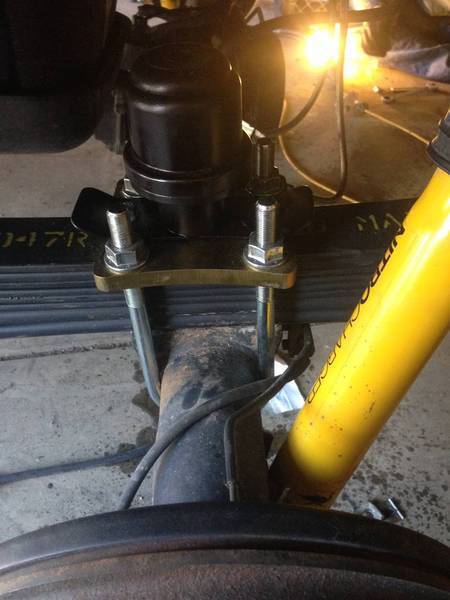

    Rear
    Disassembly: 45 min
    Reassembly: 1 hour including having to install the carrier bearing drop kit.
    The mount where the rear shock mounts had to be widened due to the thicker shock.

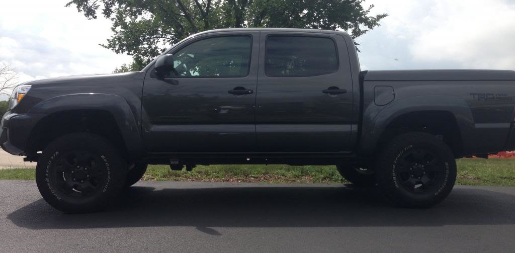

    Now all I need to do is decide on a bigger tire. I am thinking of 32" so I don't have to chop anything. :eek: Can anyone confirm this?
    Does anyone have any suggestions on what tire to run? I am thinking 32" BF Goodrich all terrain T/A's on the stock rims (painted black) with some SpiderTrax wheel spacers for a bit more aggressive stance. I do not want to re-gear. :rolleyes:

    You could go with a 33 inch tire and not have to regear. Depending on how wide you want to go you may or may not need wheel spacers. With a 285 you will need spacers on stock rims, however on a 255 (255/85/16 or 255/80/17) you don't need spacers. As for actual brand goodyear duratracs are pretty popular either in the a/t or the m/t.

    I was thinking maybe 32" or 33" BFGs All terrain T/A's. Will I have to trim with 33's? I'd prefer not to trim. Then I would determine, from there, whether or not to get spacers and how thick.

    without a spacer I believe you will rub the UCA with a 285, but with a 255 theres no rubbing until you start flexing it out, and then maybe on the mud flaps if you still have those. The cab mount is always a possible place to rub with both a 255 and a 285 (both are 33's just a difference in width)
    heres a thread on the 255's--> http://www.tacomaworld.com/forum/wheels-tires/155849-255-85-r16-owners-experience.html
    Lots of people run the tires on stock tires and generally don't have many issues with rubbing as you would have with a 285.
    Heres the difference between the 2 sizes I am talking about--> http://www.tacomaworld.com/forum/tirecalc.php?tires=255-85r16-285-75r16 (hope this link works right)

    Looks good man. Curious, did you talk to the guys at Headstrong about getting the AAL instead of the DAKARS & adding the UCAs? Looking on their site now the complete kit comes with the DAKARS & no UCAs, but it looks like you only paid a couple hundred more for the set up you have.
    Thanks. Also, I have a few friends that run the 255 KM2s & theyre awesome. No rubbing & no trimming with the 3" lift due to the narrow width. Goodluck.

    Yes I emailed headstrong and they will help you customize the kit to your needs. I didn't get the dakars for now...I will, however, upgrade in the future. But for now and for my needs/uses, I am happy with the kit I chose.
    Thanks I hope to get new shoes next spring/summer. Looking at 255/80R16 or 285/75R16 with 1.5" SpiderTrax BFGs All terrain T/A's. I like the second choice cuz of the little bit wider stance, but I might need to find someone in my area who could help with the cab mount chop if I needed it.
    So many decisions..
