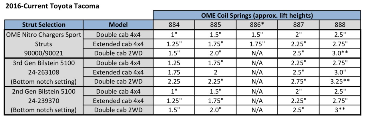

    Went with them as they provide just a little more lift, and they are considered a medium duty spring which I figured would be better off later on. Here is some height information based on the springs from OME.

    Yeah thanks for that! I've seen that chart. That is why I think i'm going for the 887's I just want a couple inches of clearance without all the drive line issues. Thanks for the chart mate!
