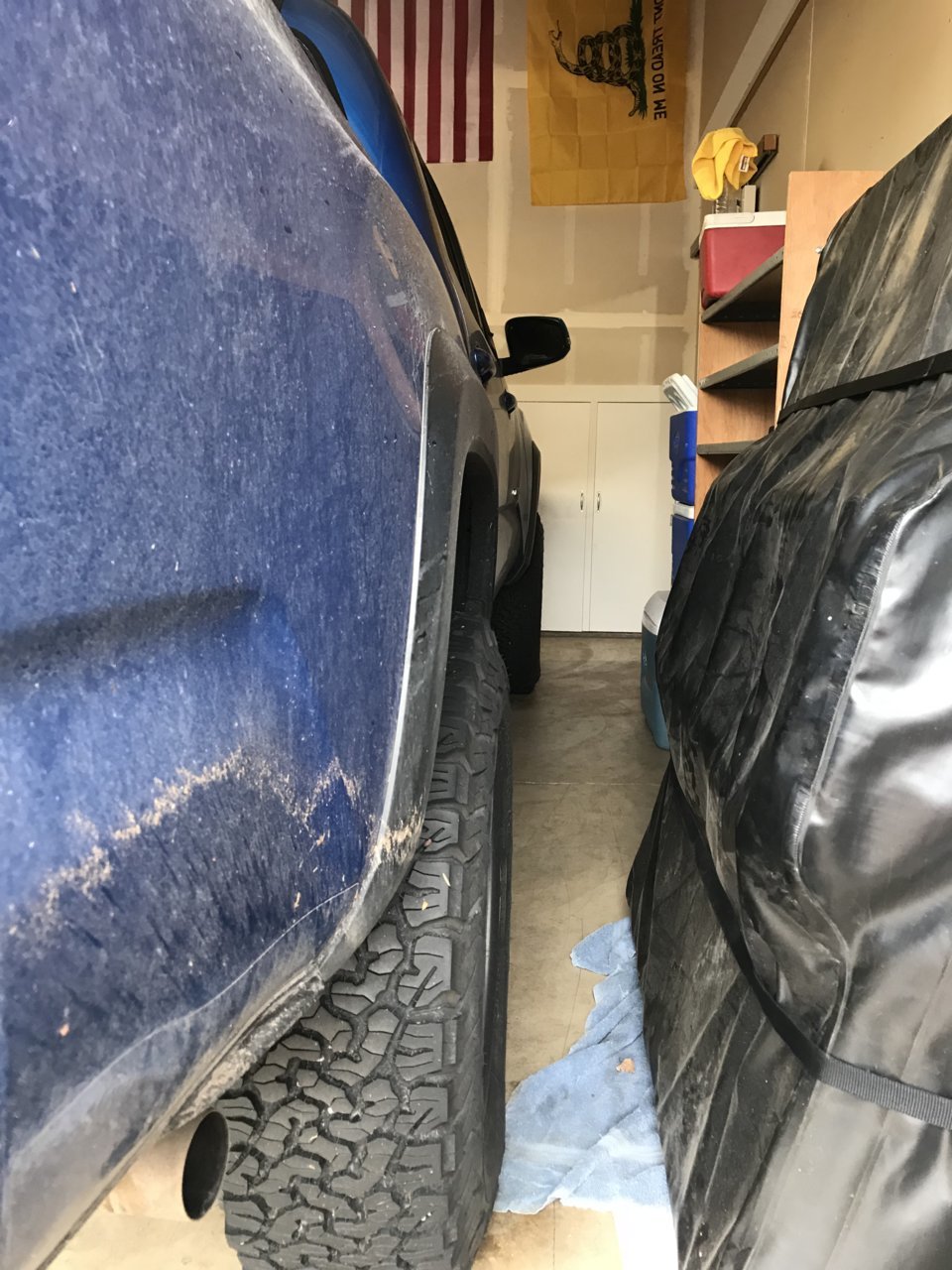

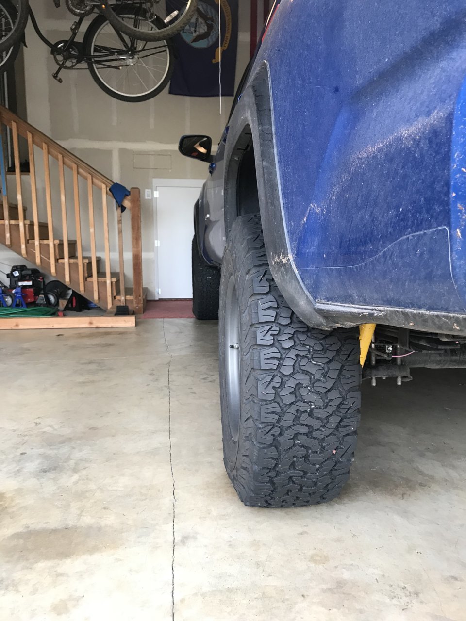

  6. Jan 11, 2019 at 10:51 AM
    #26
    KalamaKid
    KalamaKid [OP] Well-Known Member
    Aug 3, 2008
    #8323
    5,697
    Jason
    Oregon
    same shit as everyone else
    These are about as flat as the earth is round
    B1CE84DD-4B82-4919-BC6C-7C2F588B5E1B.jpg ACDB17F0-3846-4F22-A46D-40870CB20AF2.jpg
    Well it’s only 1.75-2inches of lift. Camber and toe are good. A UCA isn’t going to change your camber or toe. Caster is the only thing an adjustable UCA is going to change.
    FWIW I ran LR UCA’s on my 08 for 10 years. They didn’t help me much. Spend the money if you want it’s up to you. Id just wait till the stock ones go to shit and buy something new then. The stock ones are worthless once you take them off. I wouldn’t even stress pre mature tire wear. After 45k any MT or AT has lost its joy at that point and should be replaced anyway.

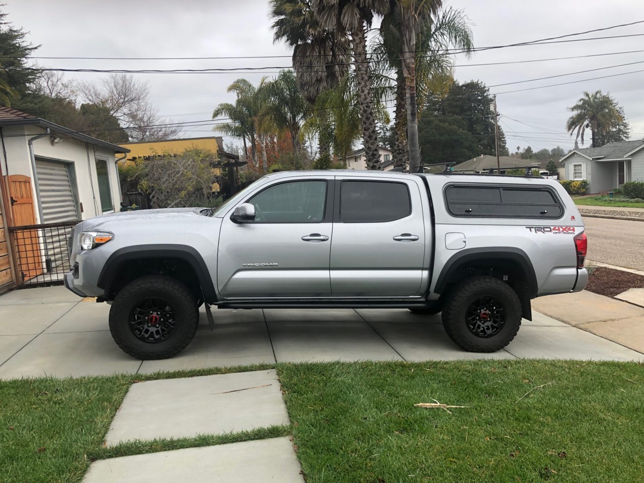

  10. Jan 11, 2019 at 11:03 AM
    #30
    jschwerdtfeger
    jschwerdtfeger Well-Known Member
    Apr 23, 2014
    #128305
    257
    Jeff
    Santa Cruz, CA
    2020 Tacoma DLCB TRD Off Road
    Fox 2.5/2.0, Deaver Expo Stage I
    Hard to tell in this pic since my driveway is at an angle, but I have something similar to factory rake. Also running SPC UCAs.
    KalamaKid[OP] likes this.
  11. Jan 11, 2019 at 11:05 AM
    #31
    jschwerdtfeger
    Apr 23, 2014
    #128305
    257
    Jeff
    Santa Cruz, CA

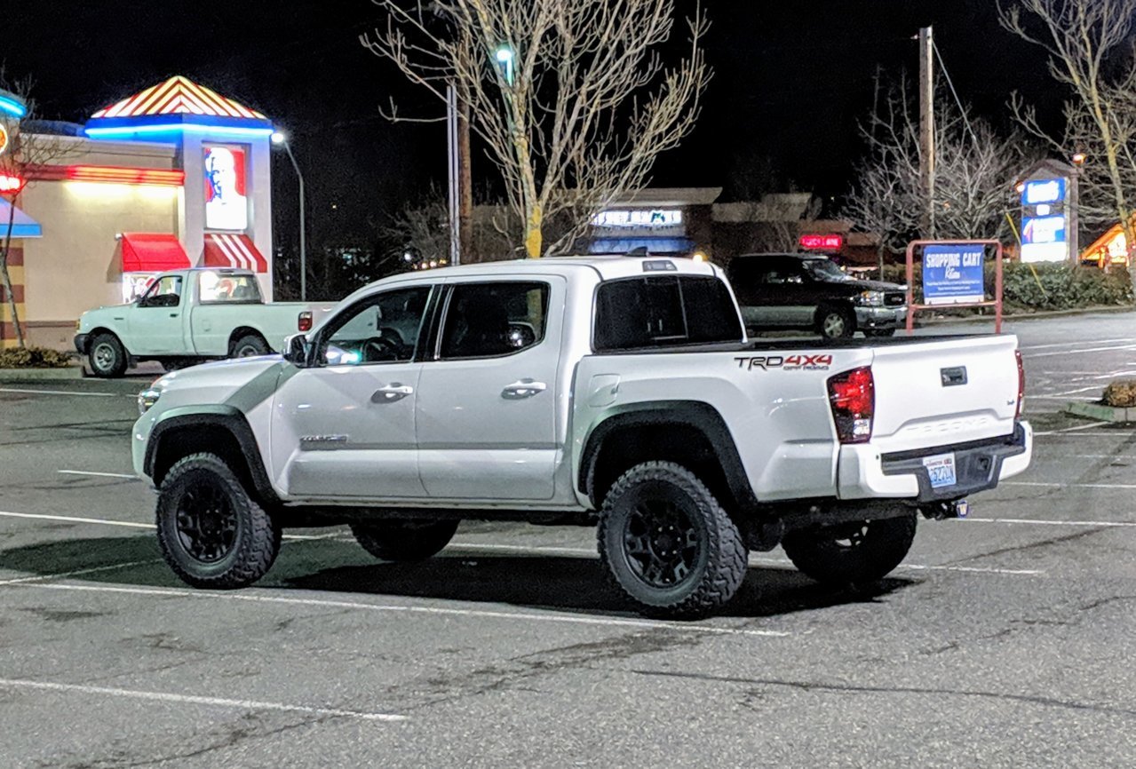

    ninernation
    ninernation Well-Known Member
    Dec 6, 2012
    #92560
    1,057
    WA
    TRDOR
    OME, ALUCAB, RCI
    90021. 4runner pro wheels 255/80/17 Cooper stt maxx

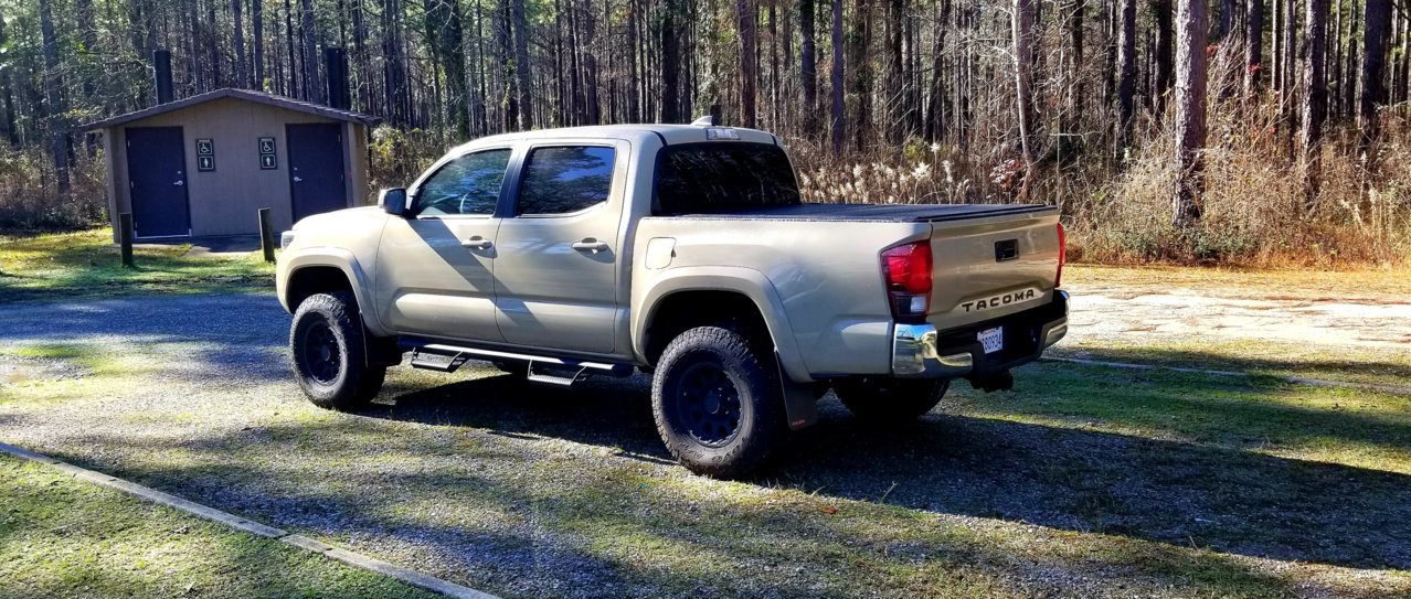

  15. Jan 11, 2019 at 5:55 PM
    #35
    DLRIII
    DLRIII Well-Known Member
    Feb 27, 2018
    #245744
    1,977
    David
    Baton Rouge
    2018 Quicksand SR5 DCSB V6
    90021 soft ride shocks/887 coils and Deaver AAL.
    Just showing it off
    jimbro and ACM0302 like this.

    ninernation
    Dec 6, 2012
    #92560
    1,057
    WA
    TRDOR
    OME, ALUCAB, RCI
    Slight rake
