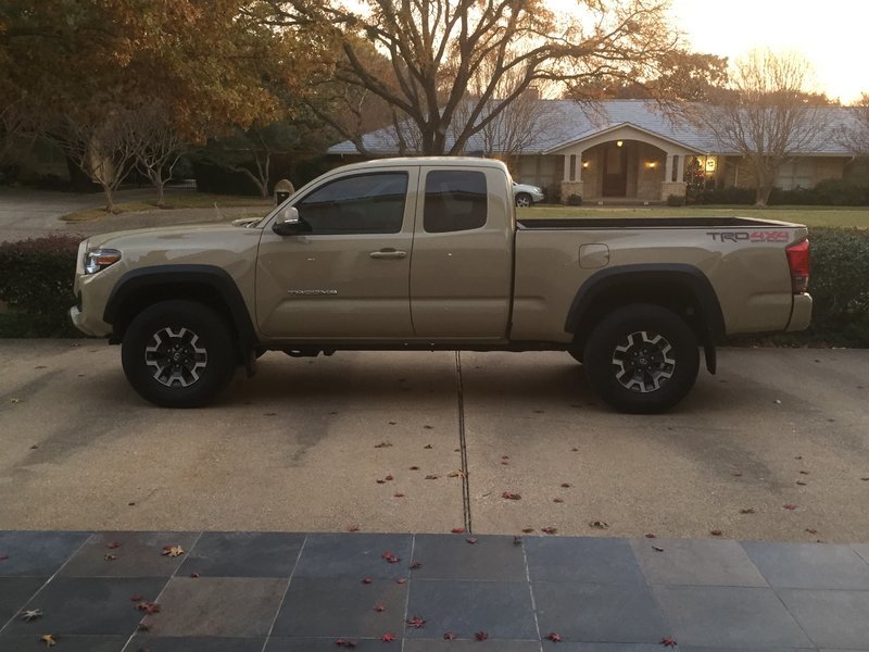

    Howdy all and Merry Christmas Eve. I'm looking into lift kits for my new '16. I'm leaning more towards the OME kit OMETAC16LKSB. I'm curious if anyone is running this kit without UCA's. I had LR UCAs with my toytec lift on my '15 and I had issues keeping the alignment. It would align great at the shop but it never lasted more than a few weeks. And that is with only city driving. They also started annoyingly squeaking about 6 months after install. Long story short, I'm looking to avoid replacing the stock UCA's.
    Also, I'm planning on going with the 4Runner pro wheels and 275/70/17 tires, so if you happen to run this lift and this tire/wheel combo, I'd love to get your input on any rubbing issues.
    And here's the picture of the truck...
