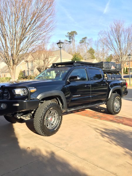

    I'm in a similar boat as @dorton with the exact same setup but did go with some adjustable uppers. I wanted to be able to set my caster around 3.2* to keep the 34's off the rear wheel well. It worked. Still need to fine tune them but I feel I can almost run 35's with only a little bit of trimming.

    Or a cut off wheel or sawsall and new bolts.

    I am on 886's and it rides smooth as silk. I also have an ARB bumper and M8000 up front. Hard to say on the lift I never really measured. I am running 34's with only a tiny amount of rubbing at half turn/full stiff up front. No cutting even needed.
