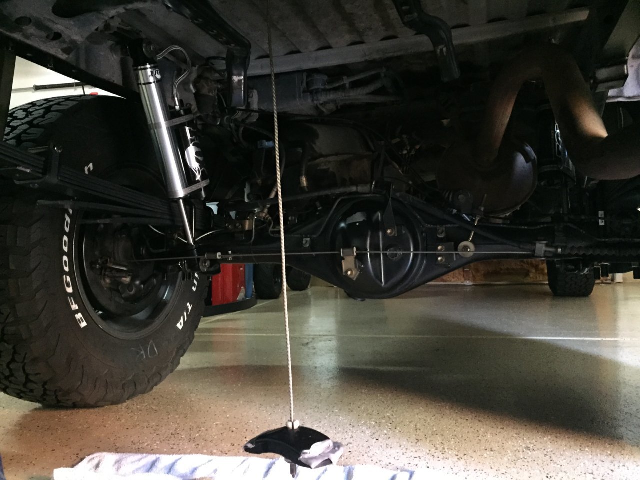

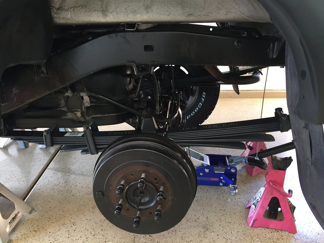

    I installed OME Leaf springs(2.25" lift),and Fox 2.0 factory race series shocks today.The question I have is will they settle?, and by how much?
    Right now The back end is a little higher then the front. I could adjust My Fox Coilover in the front up more ,But don't want that stiff ride..
    Will they settle, or should I pull a HD leaf out??
    If anyone has had this problem before, how did you fix it??

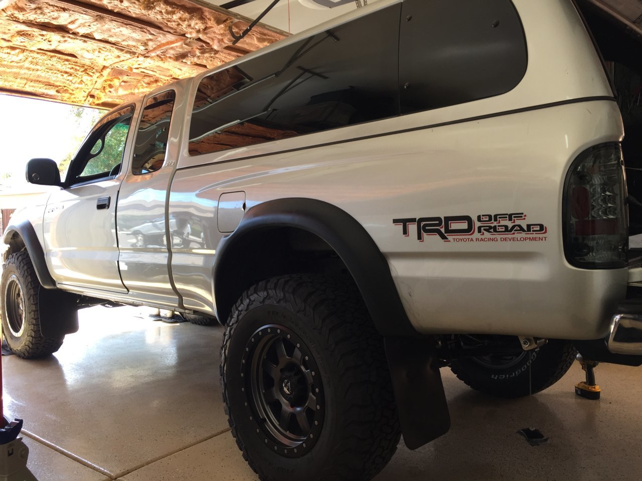

    Looks pristine!
    Location- and did the 2.0’s lift it any?
    Would like a 2” all around on one of mine soon. Not sure of the adjustments procedure on those Fox, jack it up, turn the spanner wrench? Leave it parked and spanner wrench, or is there something else?

    Yeah the fox lifted the front 2",and you can adjust it up or down. The higher you go the stiffer it is, which is ok off-road, but driving on the road I like it to be soft. The rear is lifted 2.25' from the OME leaf springs. The rear fox shocks I have on there are custom length ,because fox don't make a shock valve for 2.25' for my year, make model,...only 0-1'.So I order that shock length, punched out the mounts, and put bushing/mounts on them that fit my truck, and corrected valve ..

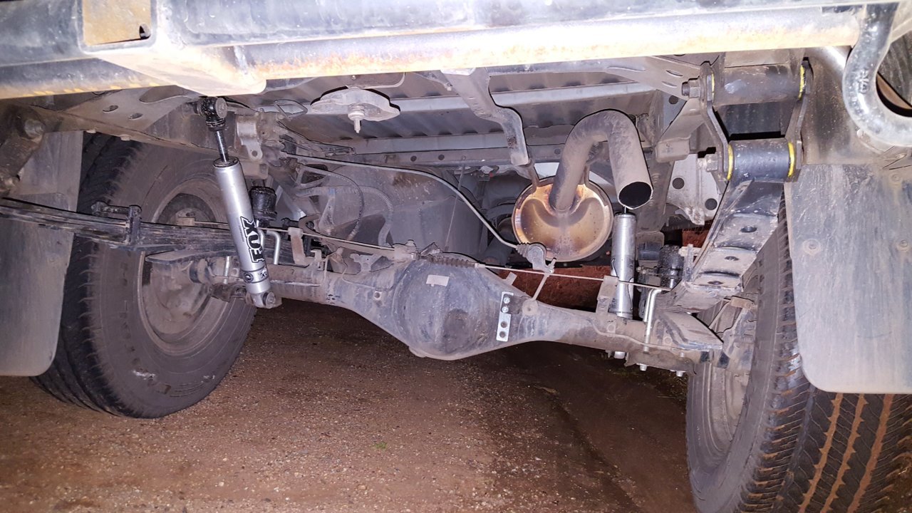

    And yeah, don't wheel until you get your bump stops in; ideally you should flex your leaf pack (with only one leaf on) and figure out your extended and collapsed lengths and/or travel.
    You've already got the shocks, so really you'll be going backwards to buy some extended bump stops made to a specific length to protect your shocks.

    I went with Wheeler's Super Bump Stops
    Old pic, from the day I installed my entire suspension (and found out I had my shocks upside down) but you'll see how little travel is left and how close the bump stop is to making contact -
    With shorter shocks, I would've killed them.
    There was an extra 2" if you directly compare with the distance to the bump stop, but you have to account for the bump stop compression as well.
    That meant at full compression I had a 1/2" of play...

    And the LSPV is seen there in that pic too. In case he wanted to see one, it's attached to the rear pumpkin with it look like a 2" or so extension. Moves that valve up back to its proper height so the rear brakes get used liek they should. Other wise might rarely ever get the rears to engage in these things. But yeah it's a good suggestion, good thing to do with the lift
