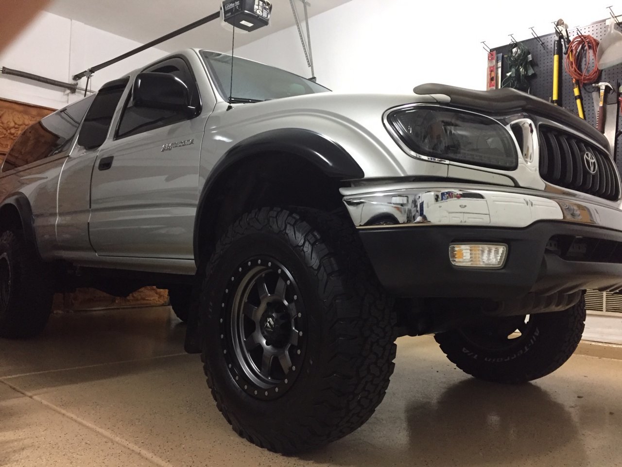

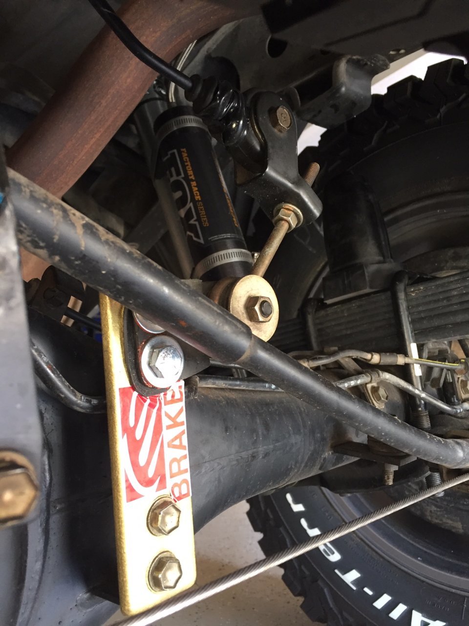

    Truck looks great man . I am about to install those ome leafs myself @tommyboy480 Do you remember what torque you set the u bolts, main/rear eye bolts and shackles to?
  5. Mar 6, 2020 at 9:13 PM
    #25
    tommyboy480
    tommyboy480 [OP] Well-Known Member
    Jan 24, 2020
    #317153
    82
    tom
    2003 Toyota Tacoma TRD SR5 Prerunner
    Fuel Wheels,BFG ko'2 tires, Fox Suspension, Bear cross drilled rotors,LC Engineering rack and pinion ,K&N Filter, Weather tech,Spyder headlights and tail lights, led HD conversion bulbs, and a hell of a lot of new factory parts!!
    I think its 95ft lbs,I just set my torque wrench to 80ft lbs,then went pass that by feel, also put ;lock tight on everything,
    Make sure to torque it down when the trucks on the floor under load,sung it when on lift,then lock it down when on the floor if that makes since..

    Will do Thanks. How does it ride ? Shocks looking :headbang:

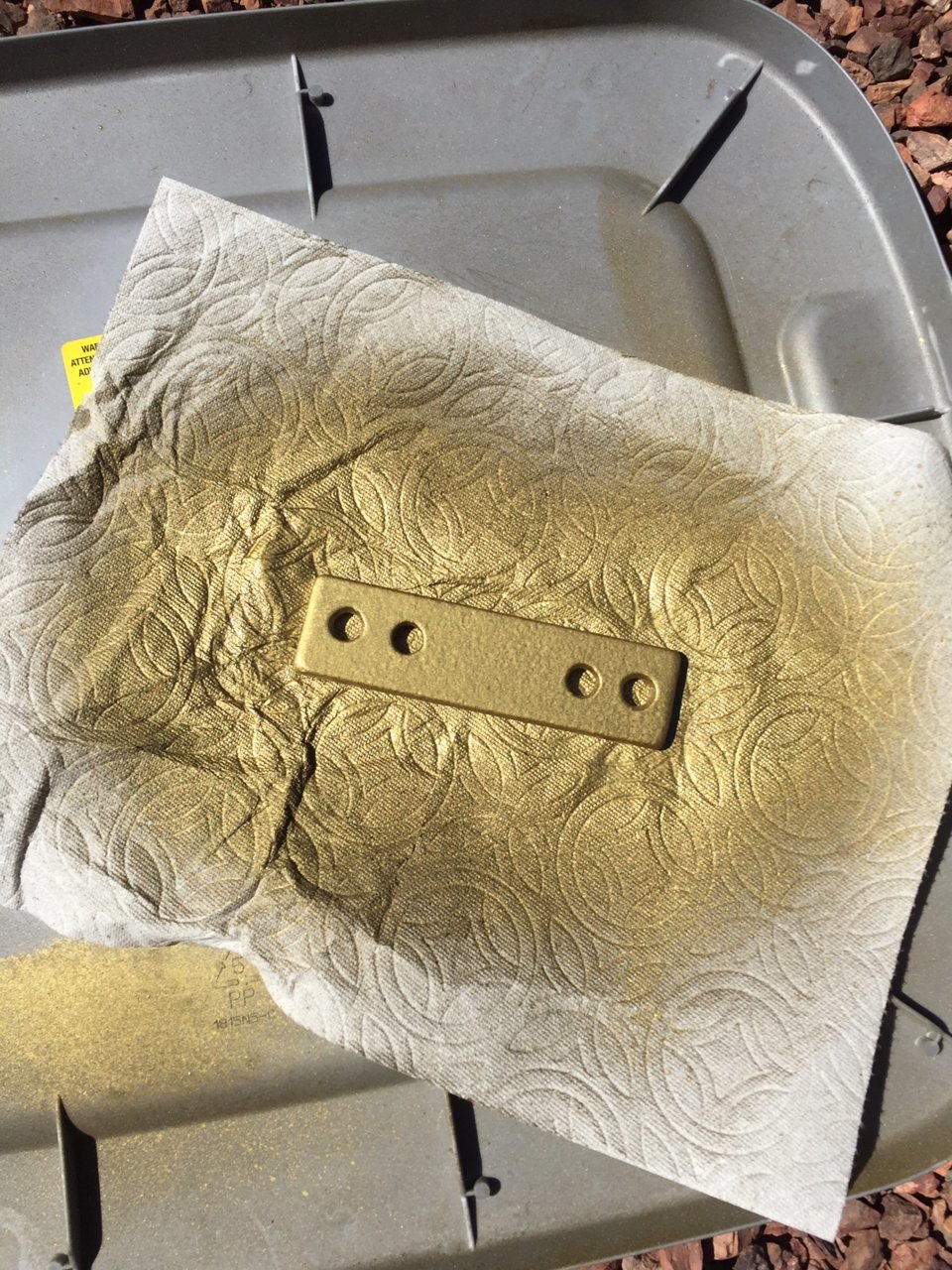

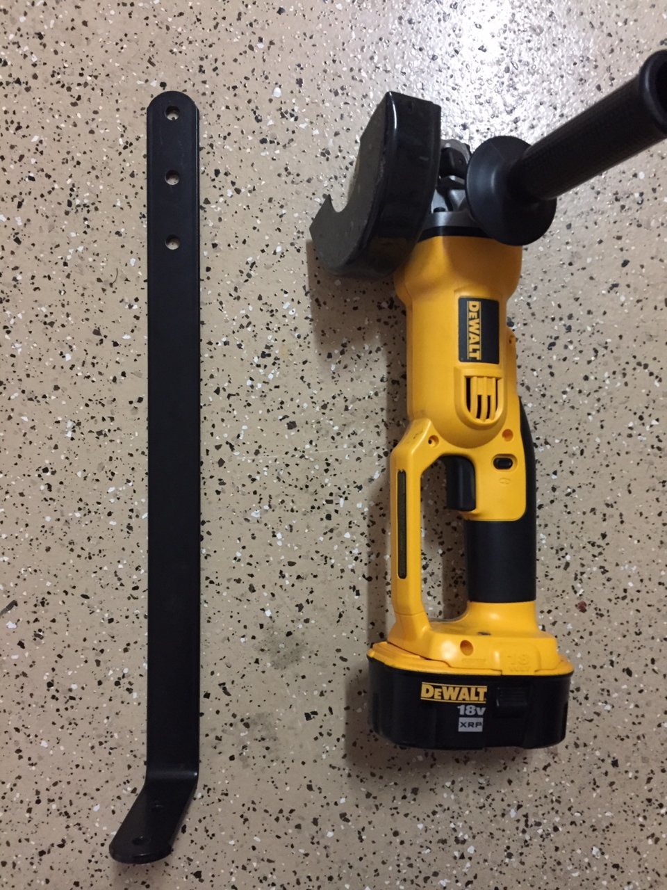

  12. Mar 7, 2020 at 2:04 PM
    #32
    tommyboy480
    Jan 24, 2020
    #317153
    82
    tom

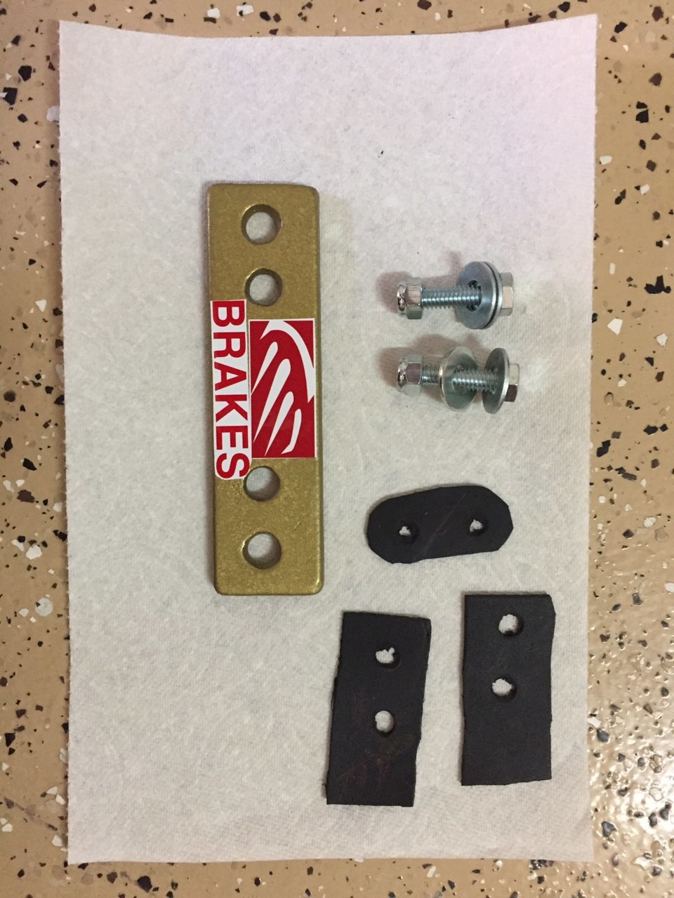

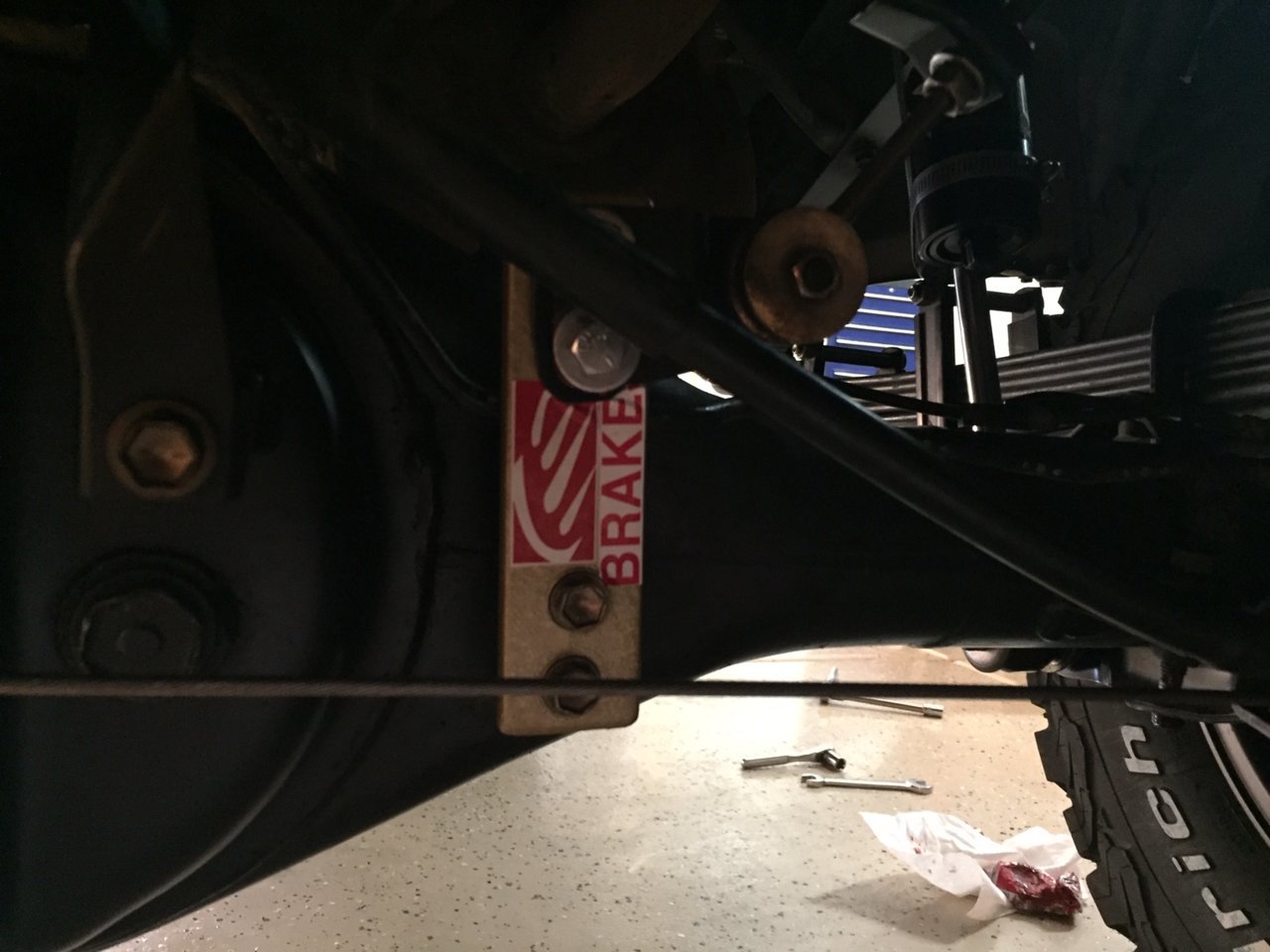

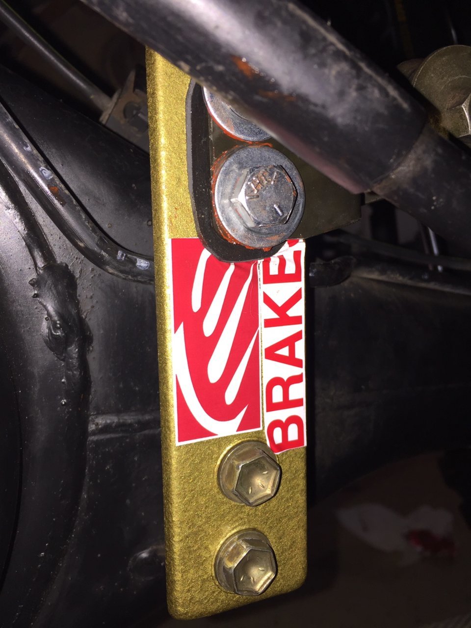

    Built that BPV Bracket today!,This is my Baer Racing Nock off Bracket ..lmao
    looks and is better then the ones I seen onlne I think.

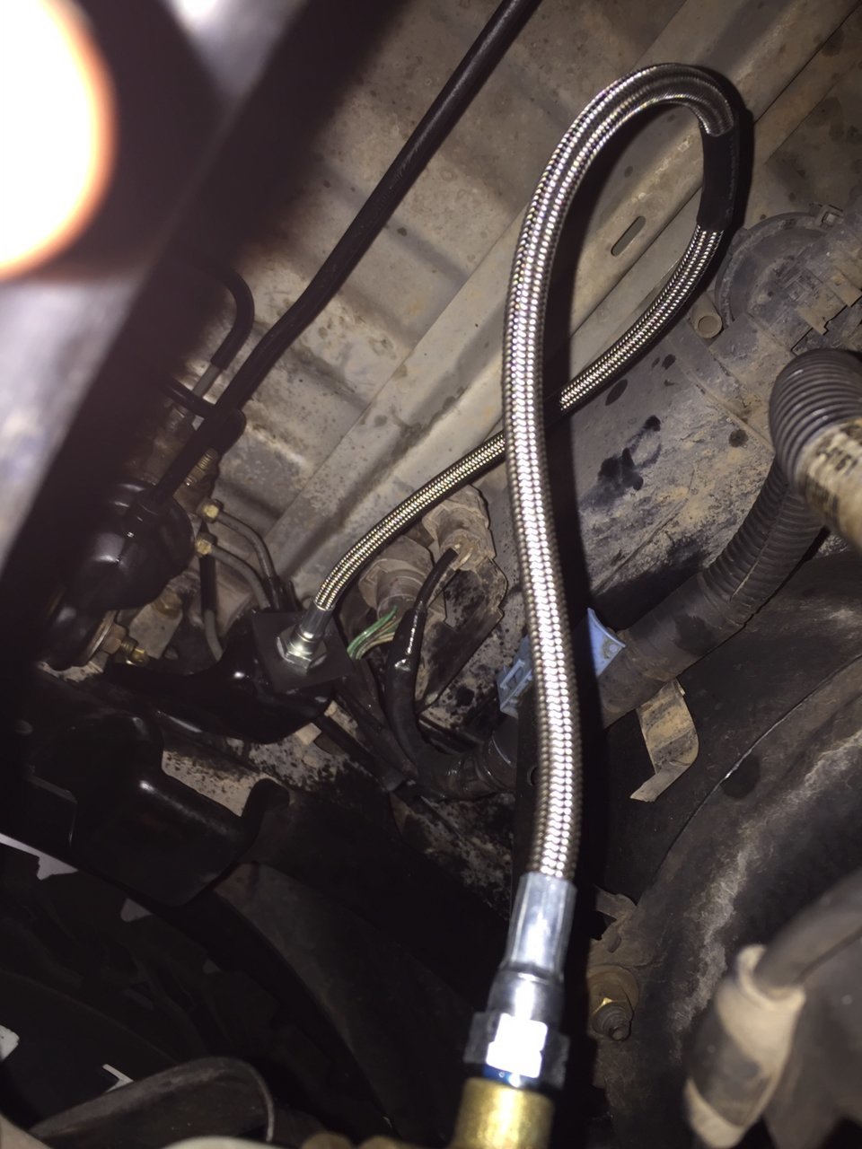

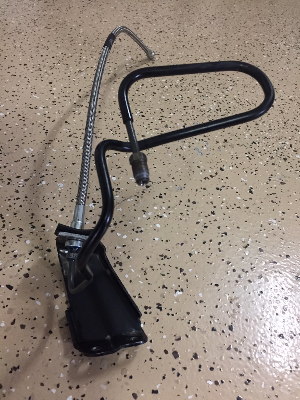

  14. Mar 12, 2020 at 8:35 PM
    #34
    tommyboy480
    Jan 24, 2020
    #317153
    82
    tom

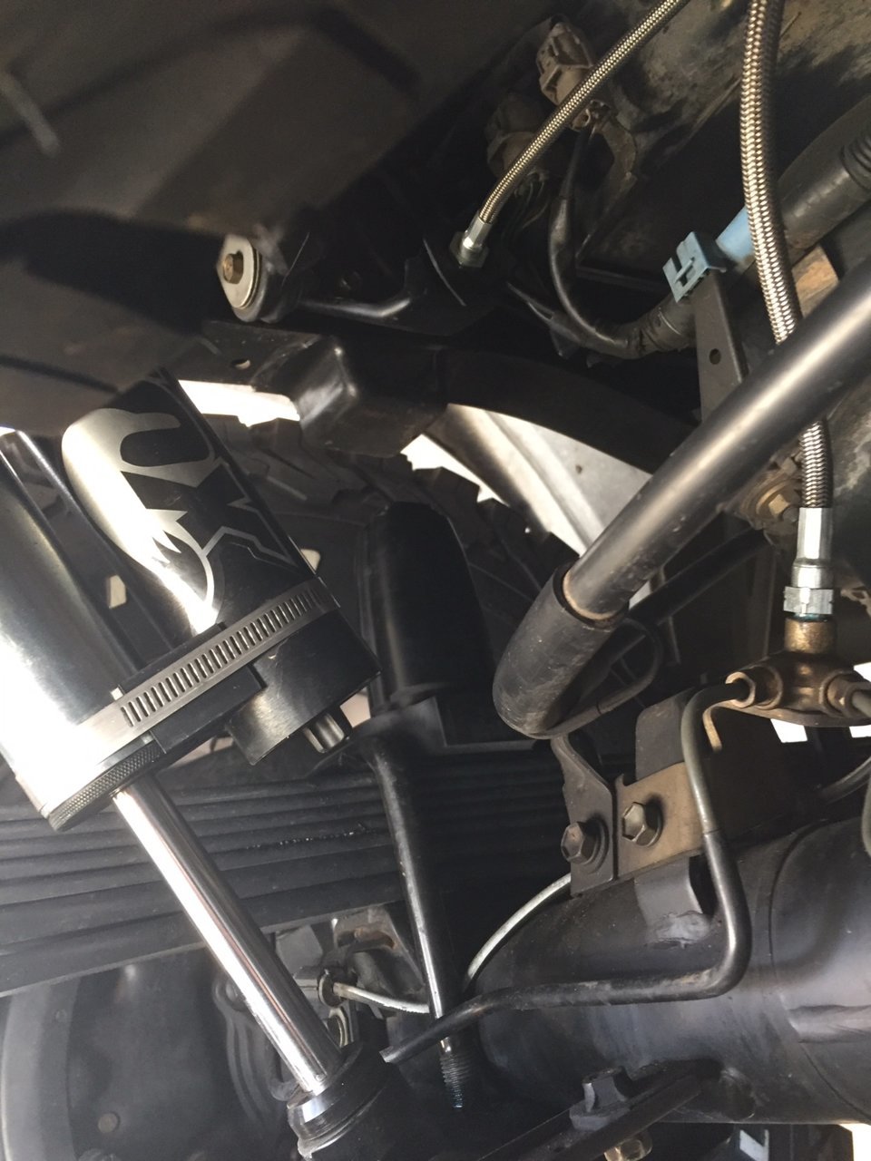

    Finally Installed my Rear Brake lines Today.!!Now just waiting on my DuroBump Stops to show up!!

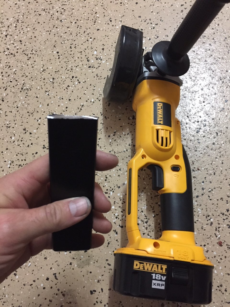

    duro bump stops finally showed up!!worth the wait ,
