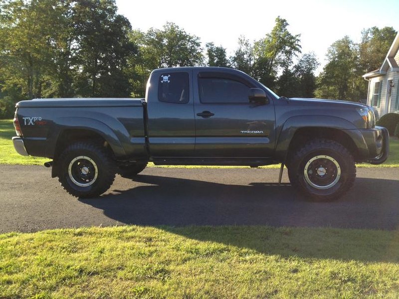

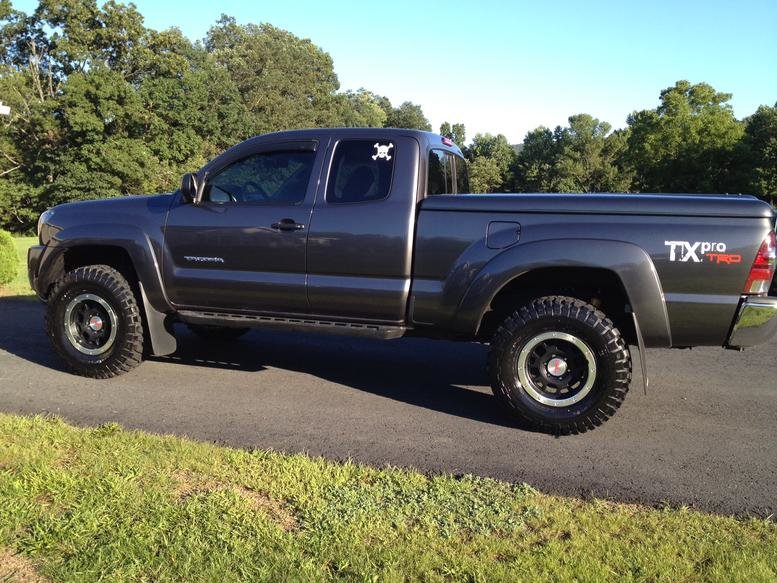

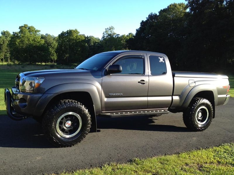

    I'm happy! 285/75/R16's
    Fit perfect except hitting the corner of the plastic inner fender lining..
    A little trimming and all good!

    Nice! What set-up did you go with? 885? and what in the rear?
    I love my OME lift.. :)

    I love it too... rides so awesome!
    885x up front with the OME shocks all around.
    2 inch AAL in the back.
    No top plate spacer.
    Worked out really well with the Access cab.. Misses the stock UCA by almost an inch at full turn.

    so you get 3" up front with 885's only with no top plate spacer - is it 2wd or 4wd?
    285 is one fat tire, but it definitely looks sweet, lol. love the TRD wheels too

    I think you should get some dakars in the back. It looks too low. I prefer the rake going the other way since I do haul stuff sometimes.

    It is 4wd.
    Not sure if I got a full 3' up front but I'm gonna say it's gotta be close since I had very minimal rubbing on the plastic lining and clears the UCA with no problem..
    Probably 2.7 at least with 885 because it's an access cab...
    I read somebody else on here did measurements and it was about 2.7 with an access cab

    btw are those the stock running boards? look nice, want to get those for mine also at some point.

    You Probably got around 2.7" up front.. I got about that out of my 885x's but wanted alittle more, so I put in a 1/4" spacer and now Im at about 3.25"
    You should def. ditch the single AAL and get progressive 3 leaf AAL from wheelers and just leave your overload leaf in for 2"s of lift.. Thats what I got, and it rides 10x better then a single 2" AAL..
