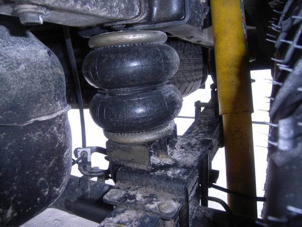

    I made a custom spacer out of 1 1/4" square iron tubing. Works great! I do quite a bit of nasty forestry roads with a good load (1000 lbs in bed) but no wheeling per say. I have about 19K miles on my setup without any problems.

    You probably don't need more than 1 1/4", not even sure if you need spacers for 2" of lift. When I took that pic, I had the Dakar leaf pack giving about 3" of lift. I have since added another leaf (D29XL) , now I'm probably closer to 3.75" and haven't had any problems with the bags. I believe Firestone have spacers for lifted trucks, you could probably give them a call to see what they say for your situation.
