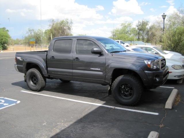

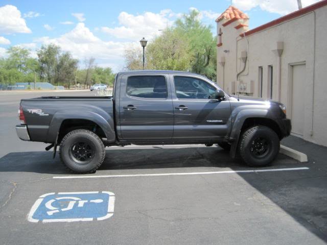

    My truck with 265/75r16s. 1.75" 5100s up front with rear spring TSB in rear.
    I just bought some LR UCAs and looking into the 884s or 885s and getting a 1.5" AAL from toytec.
    Both the front and the rear settled a bit; so I am looking into something just below 3" to account for future sagging.
