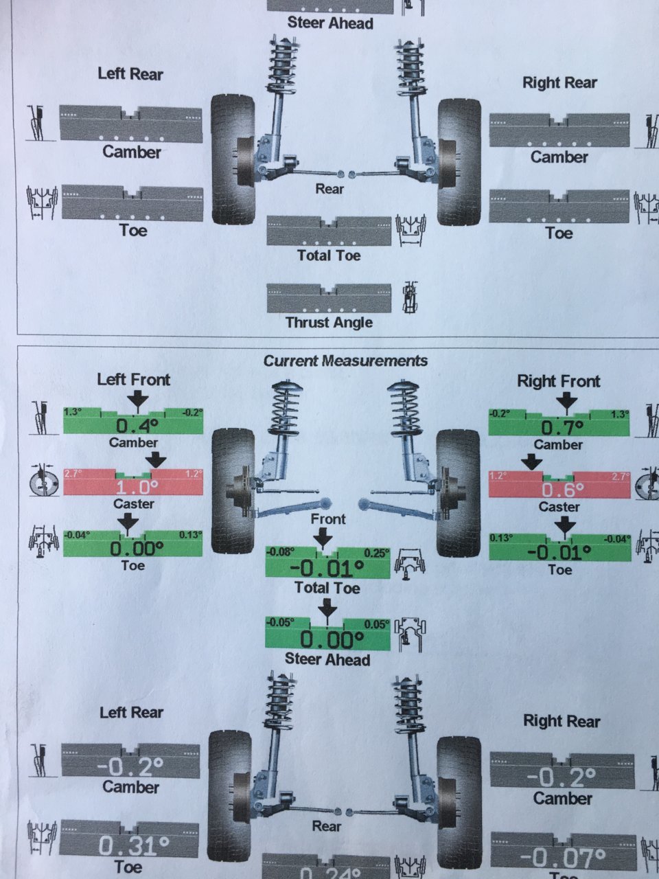

    So I got an alignment done over the weekend at Firestone and they told me this was the “best” they could get it, within specs for my particular truck (they plug in the make/model/year and the computer tells them what’s spec’d for that particular vehicle)
    Visually I can see the camber is off bc the bottom of the front tires are slightly inward, I took it back yesterday and they again set it up on the machine to re-Check and anything was still “within specs”.... he said that they can only align to what is spec’d from factory on the computer, he said that if I had different alignment specs for my particular lift kit than they can tweak it to that.....below are my numbers I’m not well versed in alignment #’s
