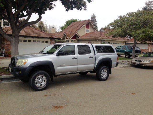

    OME lift kit / Fifteen52 Analog wheels
    exact same set up as my tacoma DCSB (885 w/front spacer / sport shocks / dakar rear leaf )

    i did the front (1st day afternoon ) the rear leaf and shocks (2nd day afternoon) I split the work in 2 days
    no instructions from ARB, but it was straight forward to install
    I did however get the front shocks and 885 springs assembled by the vendor who I bought the OME kit from
