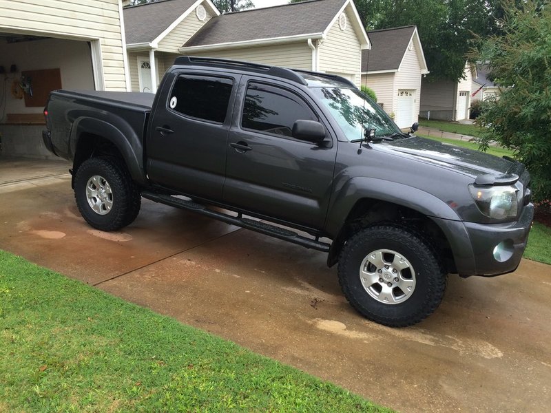

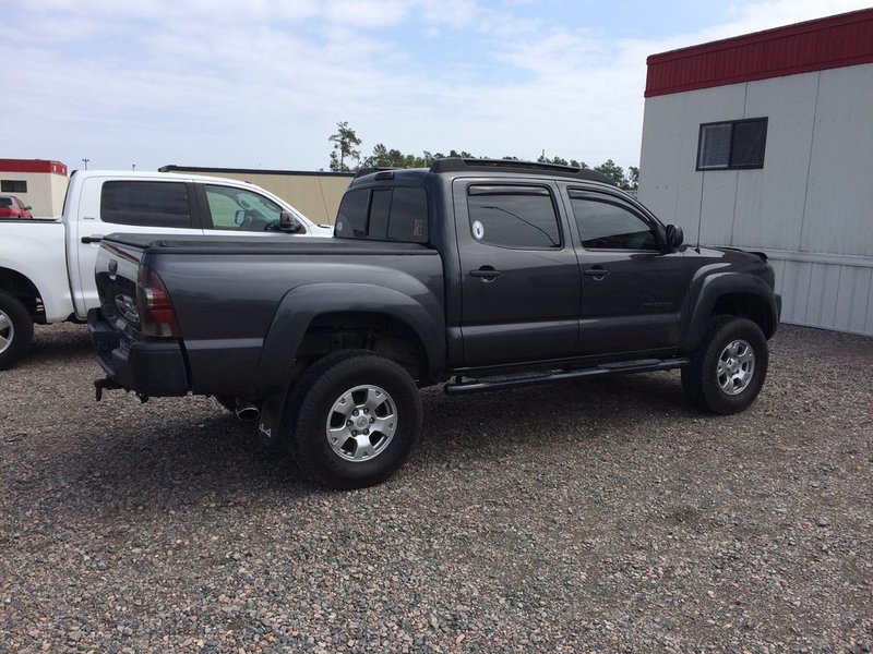

    I have the 887s with LR UCAs, love the ride. Have had it for about 8-10k miles, and love the stance and ride. Here is a pic of my truck with the lift. The first picture has 265/75/R16 Toyo Open Country AT2s and the second picture has 285/75/R16 Cooper ST Maxx's. I have only felt the harshness of the 887s when I went over a speed bump too fast because I didn't see it, but other than that I love the ride (and the bigger fatter tires always help to cushion the ride).
