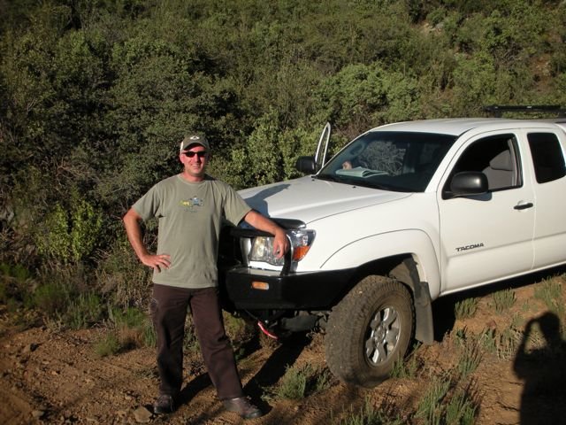

    First month of ownership... This month I'm removing front air dam, and also Rhino lining the bed.
    Earlier this year my friend Chris convinced me to do a suspension upgrade with OME. I did the front with 886s since I was putting on an ARB bumper, winch, and lights, and a full 8 leaf rear with OME shocks there as well.
    After 6+ months of use and putting over 6k miles on the truck I can say that I love this setup. Worth every penny. The truck sits about 2 inches higher now and has much better handling. I can drive confidently and faster down some pretty harsh terrain, and also my highway handling is better also.
    Here is a pic of it this summer while out in Arizona...

    Looks GREAT! Dwight!!! :D
    What He said ^^^^
