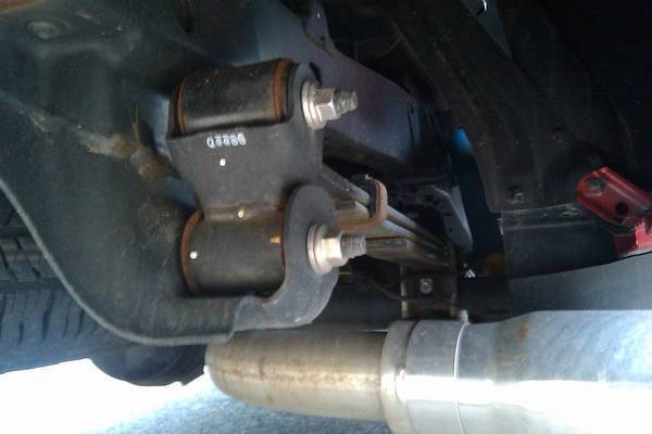

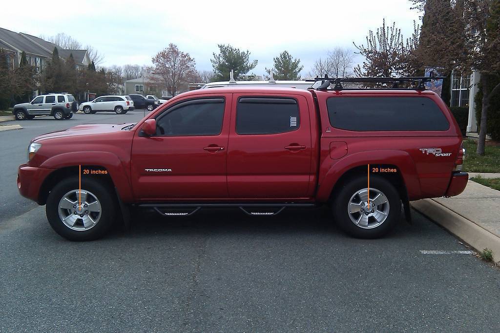

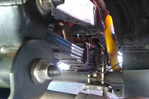

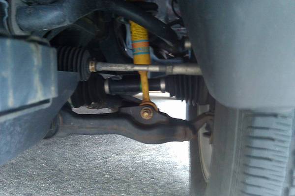

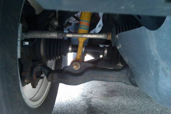

    Here are some pics of what I'm starting with...
    Current pic
    Driver side leaf springs (yes they are riding on the overload...crappy oem springs)
    Passenger side leaf springs
    Driver side CV angles
    Passenger side CV angles

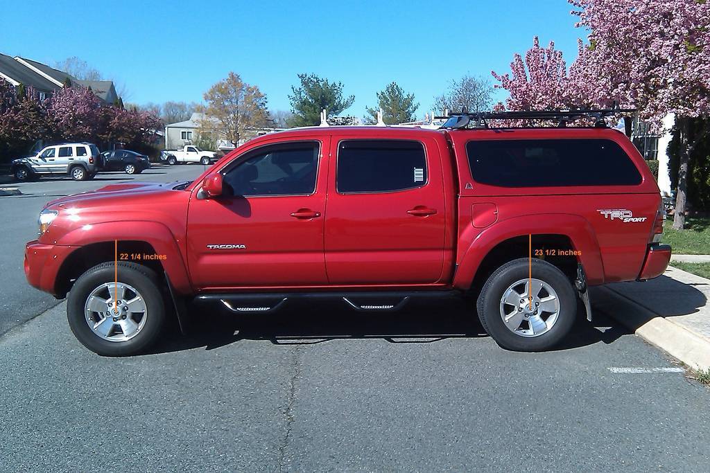

    OK, I finally got around to taking some pics...so here goes...
    Before:
    After:
    I really like how things turned out...I'll eventually get a build thread written up...
